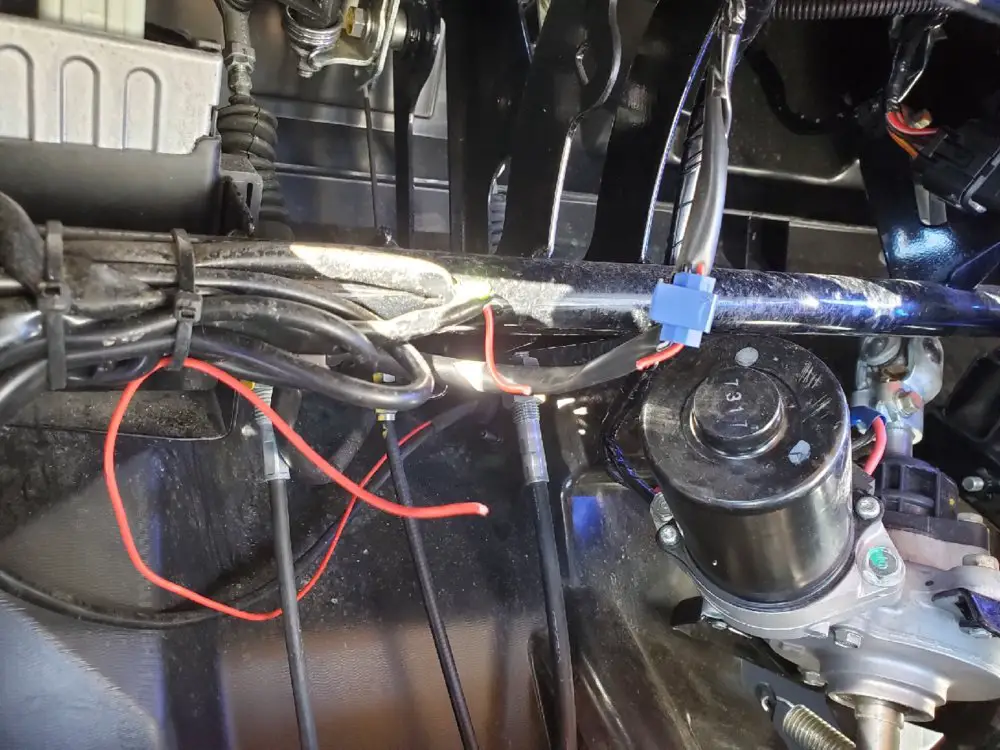

First post here. Got some recent rodent damage under the hood on my 2017 Deluxe unfortunately. It's 3 separate red wires In attached picture that were chewed through. Also found another blue piece wiring goes through like the one you see there on the ground. To my surprise it starts and rides fine. Of course, I have no clue as to what may not be working with that damage. :) Any ideas what the damage might be?

Looks like an accessory wire. Should be an easy fix!
18,509
67,207
Welcome to the club.
Ya, most definitely not factory wires.
Its something added on like lights or winch or other accessories.
Flip some switches and you will find it.

Ah, that's it. Winch must be dead.

Forgot to mention: found plastic rectangular cap on the ground from the same damage chewed up some. Identified as "CAPLUGS RC1530-1". No idea what is supposed to plug. I'll need to take another look at it.
That’s one of your frame caps, they pop out all of the time, I’ve lost 2 already.
