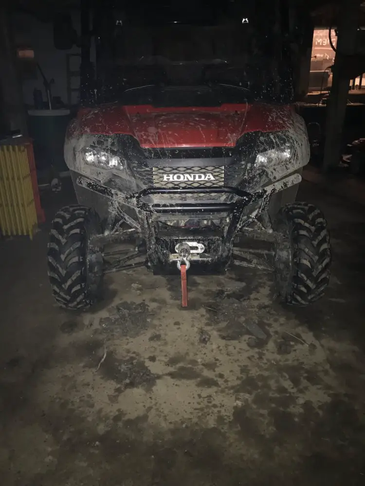

Installed my winch yesterday. Had a few challenges but it is all done and works. The viper winch mount plate is where most of my problems were.
  1. The fairlead roller that came with the winch did not match up with mounting holes in the plate and I had to drill them out. They were about 1/8" off from lining up.
  2. When the winch was mounted to the plate the top power post on it wouldn't clear the bumper mounting point. I had to space it out by using the mounting plate that came with the winch as a spacer.
  3. The power cables that came with the winch are just barely long enough if you mount everything in the perfect spot. I tried to find some longer ones but would have had to make them myself as AutoZone, tractor supply and another place only had premade cables for cars.
  4. I had to basically bolt everything together lose to get a lot of the bolts back in as they were all off from lining up between the plate, bumper and where the bumper mounted.
