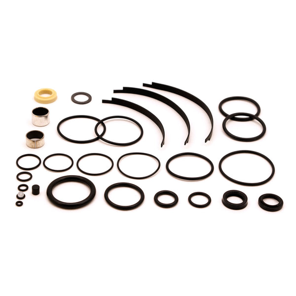

Looks like this might work...
I make no claims of being an expert. It's a $40 gamble on it, but you could probably call them up and they could make sure it is the right option. They have plenty of Fox rebuild kits on their site.
