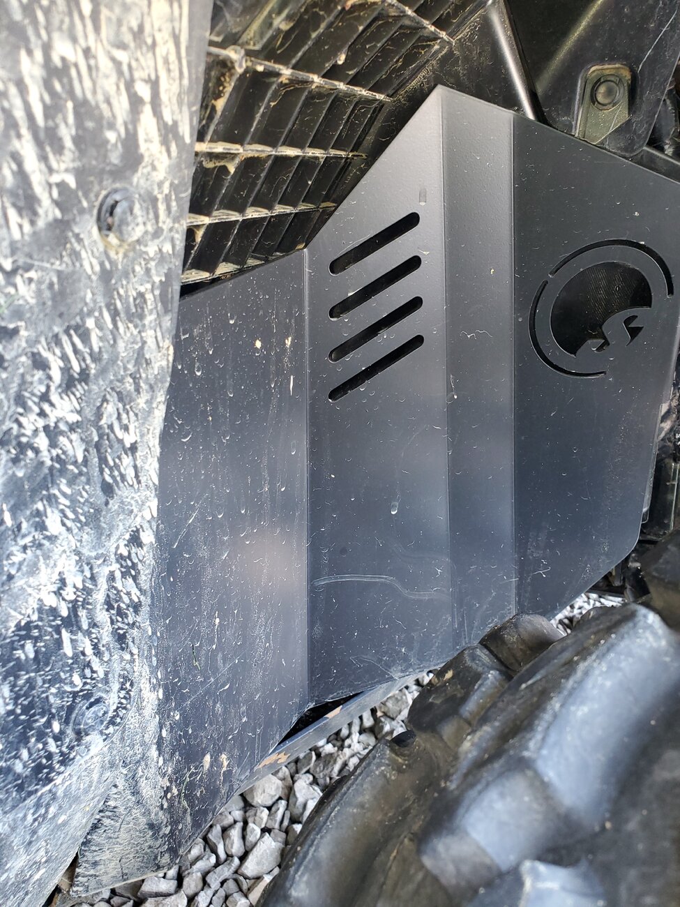

I have these installed. They seem to be good. I was initially thinking they didn't cover enough, but after having them I think they do. I think if a stick was to protrude through the fenders it would be deflected by the fender guard and go more straight up rather than an angle to passengers. I'll get you pics tonight when I get back home.

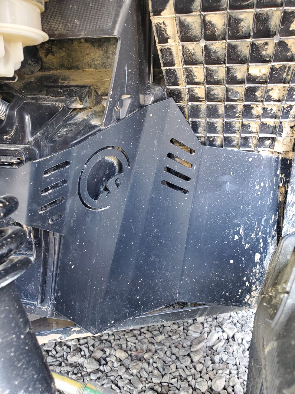

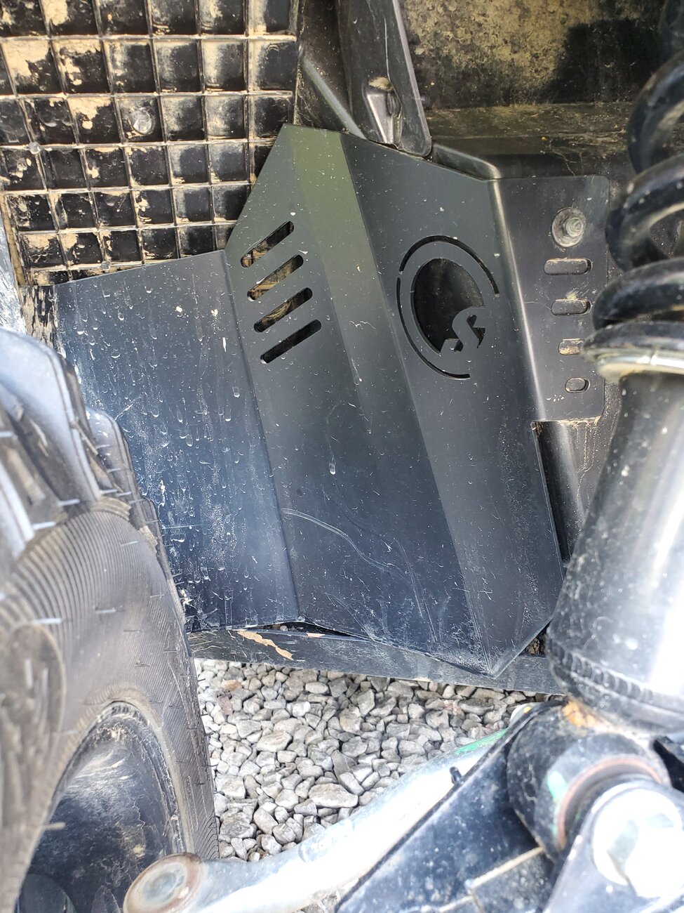

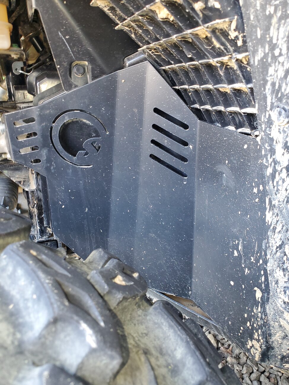

Here's your pics. I did use rivnuts with M6 bolts instead of self tapper screws.

Install was very easy. I have the 1/2" SATV skid plate. I removed 5 or 6 bolts to drop the skid a bit. Removed doors and factory push pins that hold fender in place. I did use rivnuts. Also had to bend tab just a bit where it mounts to master cylinder. My 21' has a spacer between the master cylinder and the firewall. I used a longer bolt for the master cylinder as well. Apparently the earlier models did not have the spacer.
