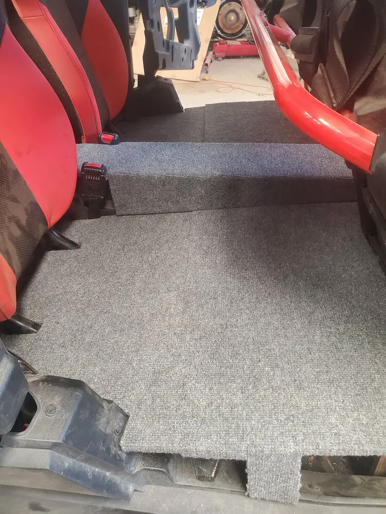

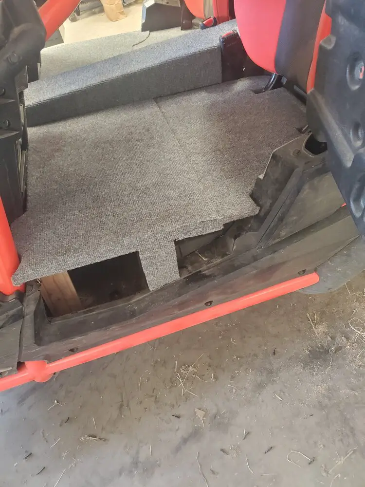

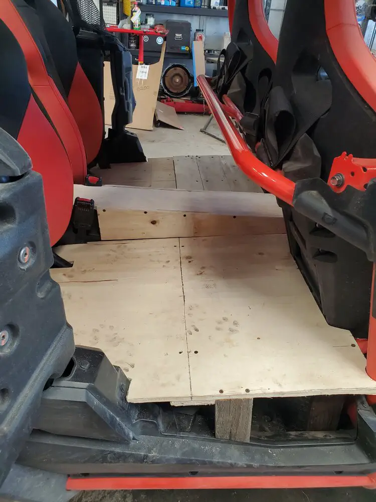

Like a lot of things for the Talon I could not find a dog deck for the back seat of my Talon. I have 2 boxers and they pretty much go everywhere with us. I know a lot of people do not take their dogs, but we do.
The deck is made of 5 seperate pieces, easy in, easy out and easy to access the fuel tank. The deck is 2 pieces on each side and a center console piece. I used scrap 3/8" plywood I had in the shop, new plywood prices are crazy right now. I cut slots on the rear side so the deck can slide back against the rear firewall. The deck slips over the seat tubing and seatbelt and sits on the seat rails. The lower seat cushions are removed. The front half of the deck has supports that rest on the floor. I bought a $20 indoor/outdoor carpert and glued it to the plywood.
Using dog seatbelt leashes, we don't have to worry them falling or jumping out of the ride. A couple of dog cushions and they will be happy cmapers.

Hey,
View attachment 272508 View attachment 272509 View attachment 272510
