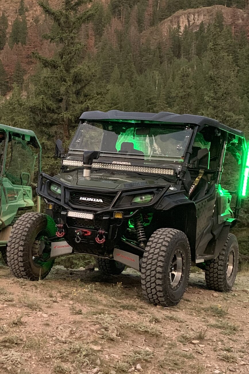

Ive been running 15” LT tires for 3 yrs now. Same size all the way around. Mud snow sand pavement been just fine

Thank you for the reply that is likely the direction I am going to go. How much air do you have in them and did you notice a difference in ride quality? Also what size are those? They look like a 235/85 but cant tell for sure
30x10x15’s
Ride quality was same off road, much better on pavement. I run 10-12 if I know im on pavement most of a ride. Other than that, 8psi

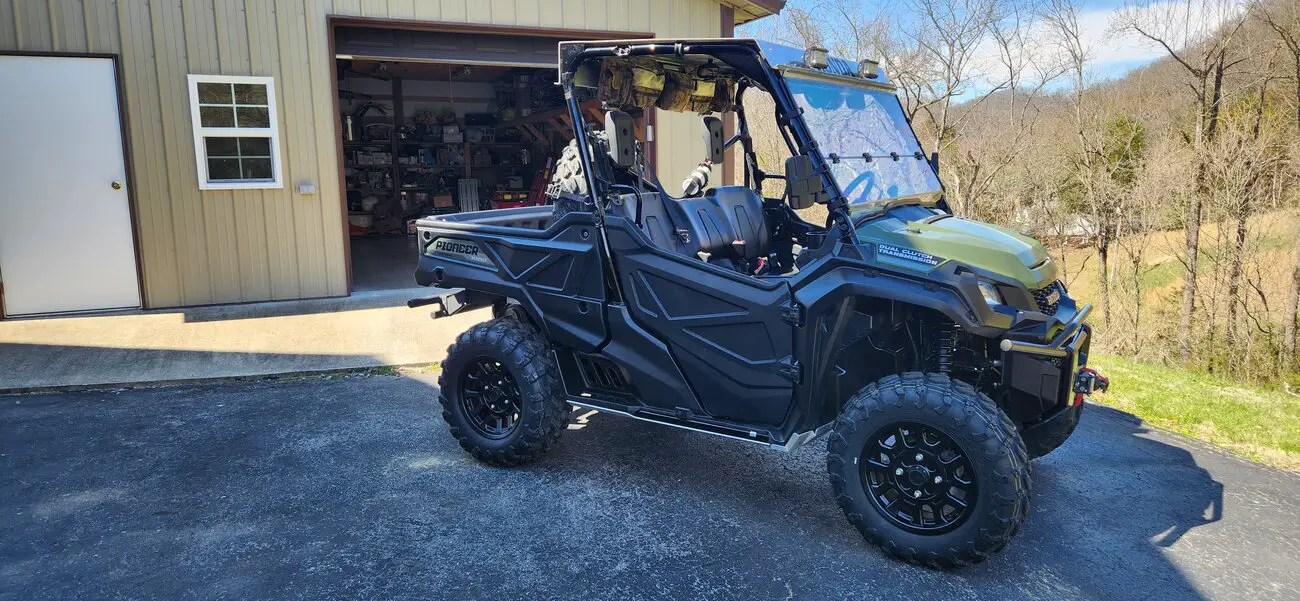

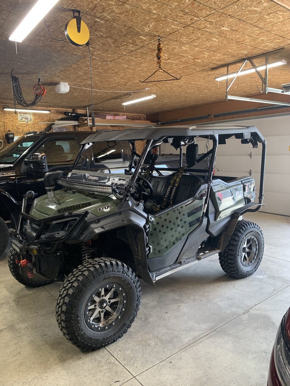

Thank you very much for the info. I am assuming you are running a arms then. I picked up the rims and tires from the Talon yesterday and they were as advertised. Fronts actually look pretty decent tread wise so I may throw them on to run them for a little while. When I replace the tires I will likely be going to a 235/75/R15 (28.9x9.3) mud terrain truck tire all the way around. I still have some time to decide on that though.
18,396
104,820
Yup, SATV arms, 1" spacers in front and 1.5's in the rear
