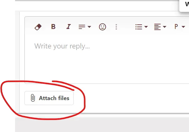

Tried posting the picture of what I'm getting but i can't see if it loaded up for ya because I have no idea what I'm looking for

Jankyeye
Jankyeye
Dec 17, 2021
839
4,031
Tampa, Fl.
@bman97
1729605932877
Reactions: CID

Sometimes it takes a bit to upload the pic, just have to wait until it uploads before you hit post
Thank ya. I'll do it when I get home because I tried testing the the plug lastnight after work an everything an I couldn't figure out what they was meaning because I don't know what I'm doing nor looking for
