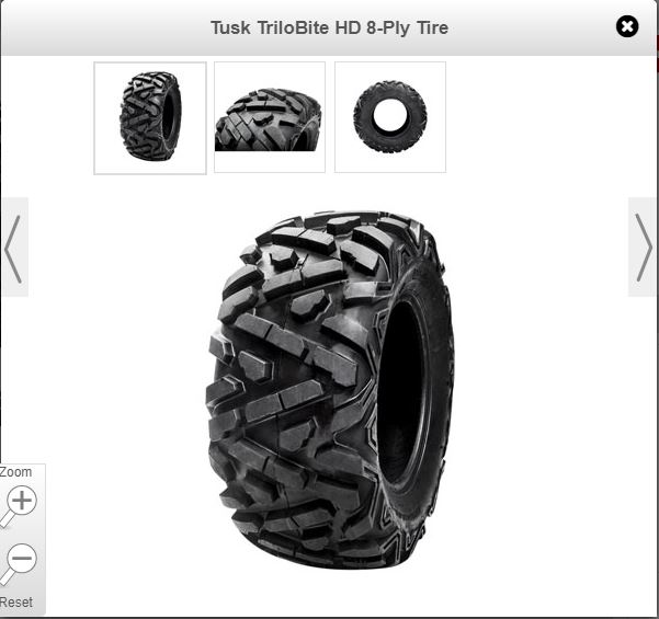

+1 for a Bighorn knock off if snow/mud are still on the to-do list. I was tempted by the Terrabites but I have read that they will clog up in heavy leaf cover maybe?
At any rate I had a couple of Bighorn front's laying around so I went with the Tusk Trilobite (Bighorn Knockoff) and have been really happy with them. That tread seems to do great in all kinds of terrain and I haven't had them on too long, but the reviews I read (mostly from RZR guys with locked rear diffs) claim they last twice as long as Bighorns.
I went with 29x11 in the rear and 29x9 in the front- they actually measure just under 28 inches aired at ~14psi and have cause no clearance issues whatsoever on my bone stock 2018 1000-5. They do make them in 27x11 and 27x9 as well though. I think the 29's fill out the wheel well a little better, I'd go that route again given the chance.
Tusk TriloBite HD 8-Ply Tire

Scratch this: just realized those sizes are only for 14 inch wheels.
Still love that tread pattern though!
