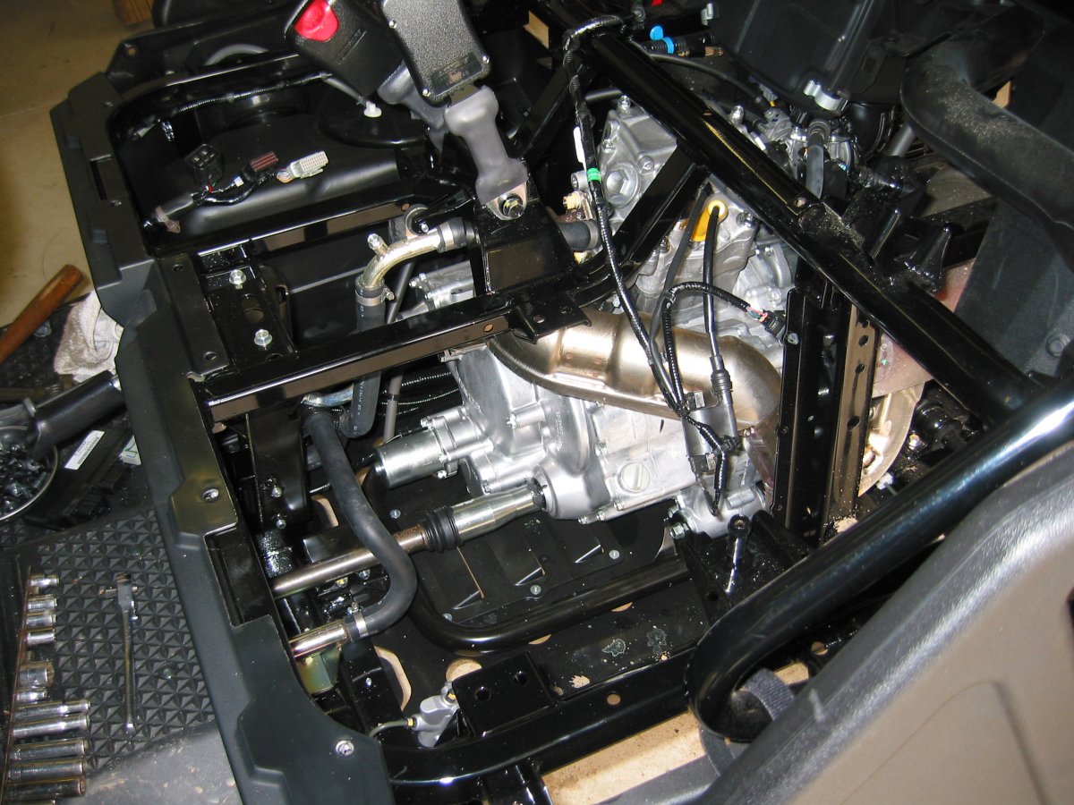

My SO (significant other) complained about too much heat coming up between the seats. So, I pulled the entire seat coverings to see exactly where the heat was coming from. I'm sure all of you old timers have had your P-500 totally disassembled, but since I just got mine, I had to find out what was under there :) The fix, of course, was much simpler - just put insulation underneath the seat.
Here's a couple of pictures of under the covers:

Wrapped my exhaust with header wrap.Worked great.

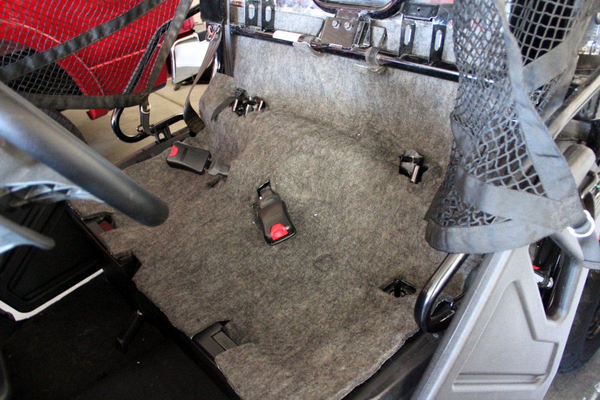

My SO complained about the heat so this is what I did. It's automotive heat, sound and noise insulation padding. 3'x4' from Amazon.
Under Seat Insulation

Helped a lot.
Did you try to measure db noise level with any smart phone app? Would be nice to have supporting data, besides subjective feel.
I use motorcycle ear plugs when I ride p500 anyway. But curious true numbers with actual noise reduction.
