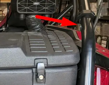

I installed the ultimate Talon cargo box.
Looks great, durable, weather sealed, easy in/out, no ugly straps, $125.
https://www.mooseutilities.com/products/?productId=121242
IMG 20200623 145213 Edit
IMG 20200623 135642 Edit
I made a mounting plate for it.
It connects to the bed frame with 8 spacers and 8 longer bolts.
IMG 20200623 145341 Edit
The cargo box mounts to the plate with four 1/4-20 knobs.

I had my dealer bring one in for me and it was too big. Rested on the sides of the Talon bed and could not open the lid as it hit the flag mount??

The box only touches the upper tie downs. There is no rubbing since the box doesn't move. In other words, it's a perfect fit.
I removed the flag mount since I'm either going to modify the cage or replace it and wanted two flag mounts.

Here's the box open. You can see the ball bungie's looped over the rear of the box. They are threaded through the factory tie downs. The front is through the tie downs and two brackets I mounted on the box. It hasn't moved at all hitting high speed bumps and is easy to remove. 5a4fe7943ac60906725c2f1ec817f69b03c16abdda8981f2525da3095fe82de0

That’s crazy...no way mine would fit. Sat at least an inch above the bed.
The box is well build and looks great. Bummed it wouldn’t work for me.

I think the video says there’s several sizes...

Would be nice to reconfirm the exact model/ size that fits, as others say that there seems to be few versions to chose from.
Interested to hear from members who says that they had trouble, exactly what model or p/n they bought.
Although @nm6r did send a link to a specific Moose model.
