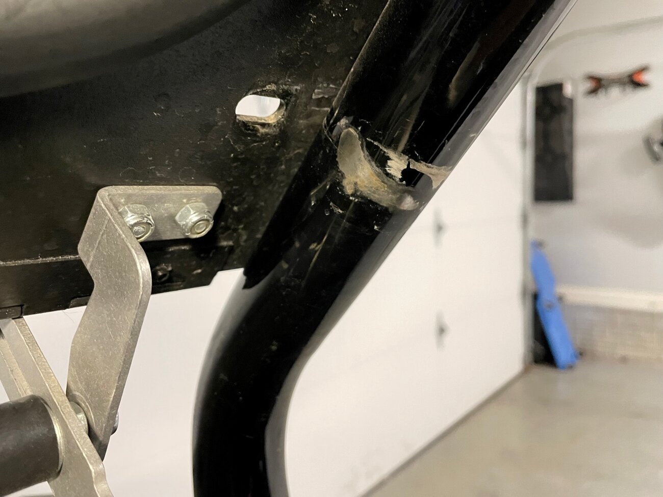

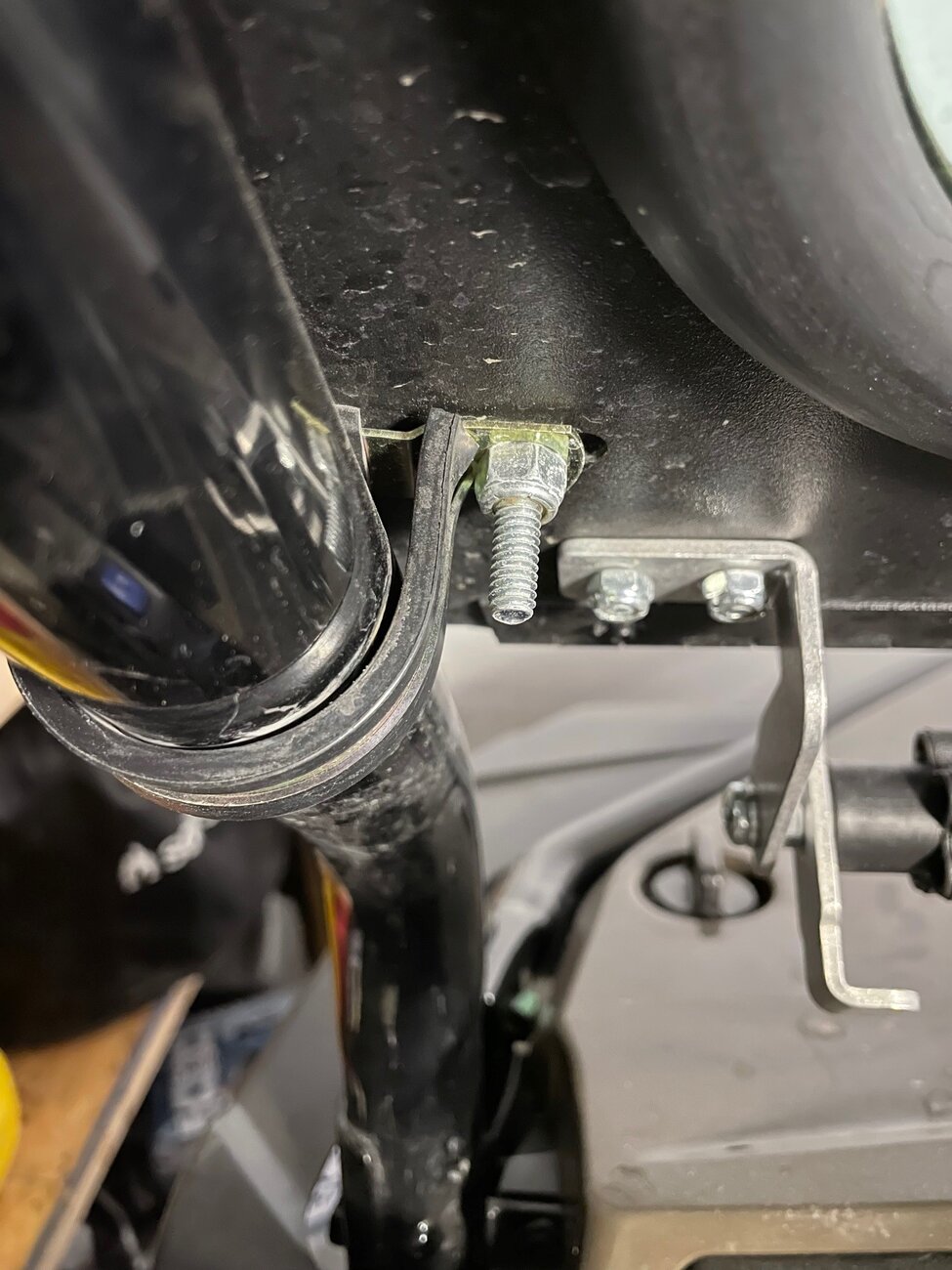

The clamps that come with it just cant get tight enough (due to design) to keep it from rattling around like crazy on rough roads. I spent 4 days in the mountains and that was enough to rub the paint off the roll cage at each clamp location.
Original Clamp:

Paint rub at clamp locations:

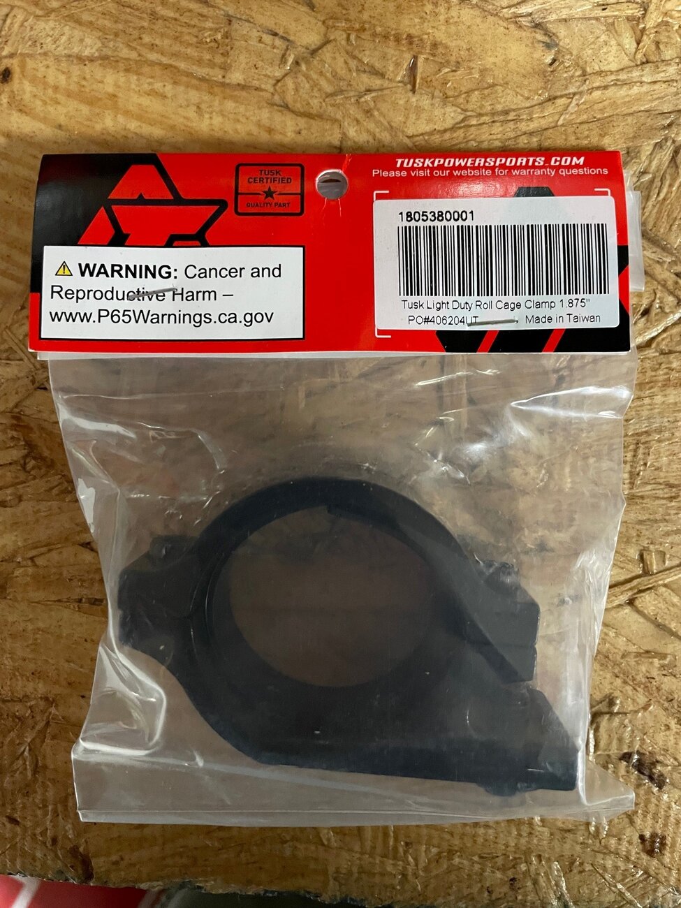

So I found some Tusk aluminum clamps on RMATV that I thought might work.

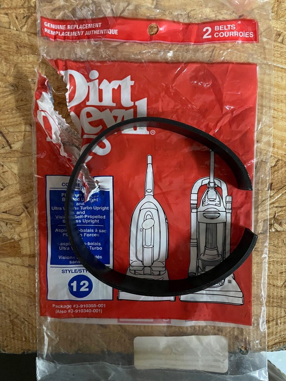

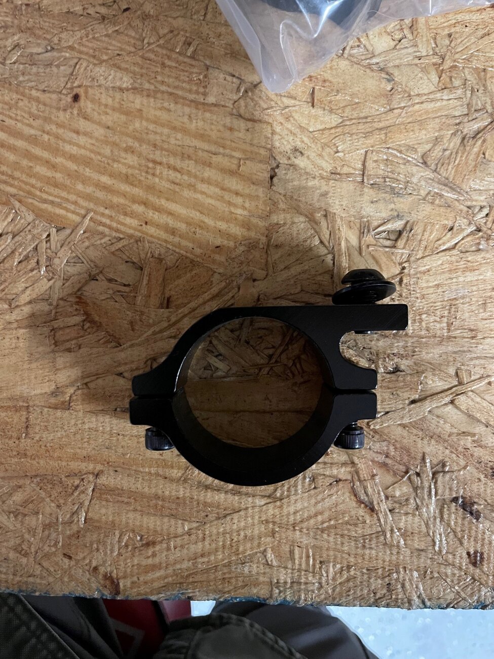

Now these don't fit the cage on the 500/520 perfectly so I had to find some rubber that was slightly bigger than what came with it to get it good and tight. What I found was actually a replacement vacuum cleaner belt at my local ACE hardware. It fit the bill perfectly!
5
I used loctite on all the hardware and this should be a good solution/upgrade to a already great glass windshield. I also used a small neopreme washer to isolate the windshield from the clamp a little so it doesn't vibrate or rattle.
