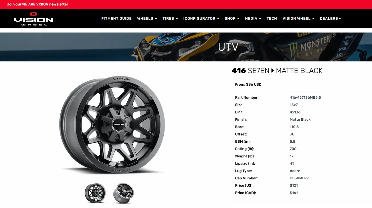

Bought this from Amazon to use as a spare for $100 a couple of weeks back.
Wheel specs are here
1737165219541
I measured the wheel backspace the old fashion way and it's 5.5", the size of wheel is 15x7 on paper but measure 8" in reality.
I mounted the wheel in the rear to see if it's was going to fit fine and it does wheel only, waiting for the Parallax 30x10x15 to arrive to get it mounted and see what's up.

The only issue i have is the factory lugnuts won't fit, the OE ones are too big.
I actually like the wheel a lot, and i'm thinking perhaps run all 5 the same. I don't need the hassle of beadlocks, the rig pupose is trail and sure there are some rocky terrain here but factory 14-15psi is working fine so far for everythng i do with the rig. Plus this thing is not exactly where i put my money, i have a Jeep for that so i just want simple in this application.
I measured the backspace of the stock OE Talon rear wheel and that is 5 7/8". Don't know the true witdh of the factory rear wheel but specs say 15x8.
Would i have any issues with this combo as a spare ?
If i decide to get the other 4 matching wheels, would i see any issues because the 5.5" backspace ? seems literally 1/2" more poke out in the rear.
I need to measure the front backspace to see how they'll compare there.
While i get for the tire to arrive, do you guys think these lugnuts will fit ?
TUSK (16 Pack) Tapered Spline Drive Lug Nut 12mm x 1.50mm Thread Pitch Black for Honda Talon 1000X 2019-2024​

Yup, they'll fit. That's what most use when running aftermarket wheels. Honda uses a round profile (bubble) on the seat of the lugnut, most aftermarket wheels are set up for a 60° conical seat.
