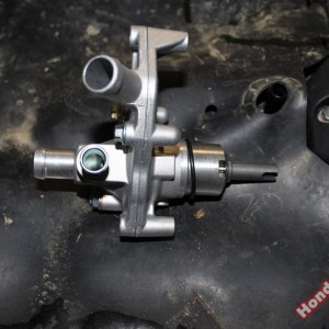

See it in this picture after new install.
4006 207f3347d72b4fa29d863d099dfb058d
OEM included one but it most likely came off.
