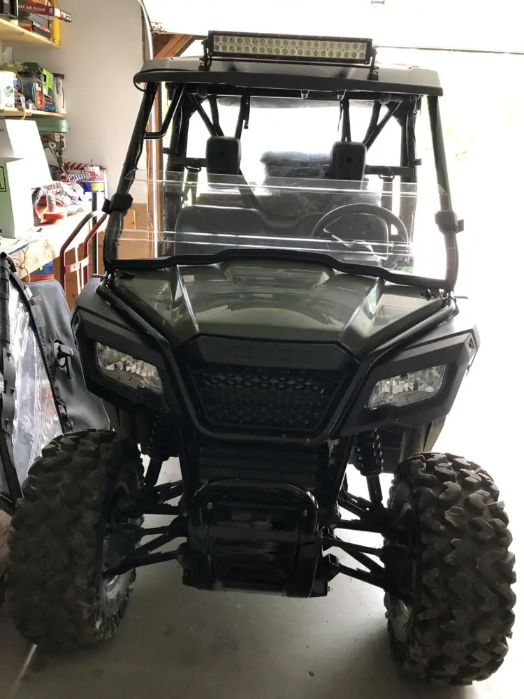

Mine is 20 on the roof... I've been very happy with it

Do you have the Honda roof? I wasn't sure it would be strong enough for something that heavy.
Yeah - it's more than strong enough for tree limbs, which I encounter all the time. I bolted it direct to the roof and have had zero problems

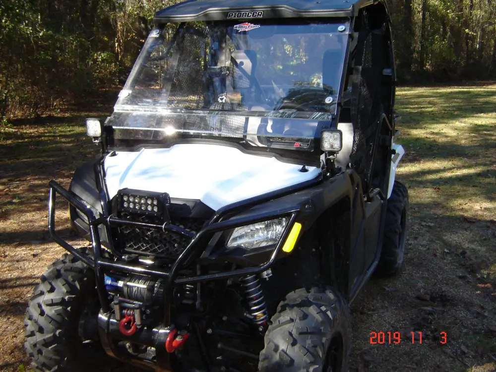

Tractor Suppiy stuff on the front of mine.Plenty of light for me.I have changed out the stock headlight bulbs for LED's as well.They are not great,but the amp draw is cut by about 50 watts.
DSC01282

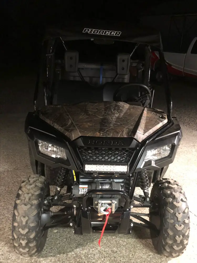

Ended up going with a 14" on the front and 2 cubes in the back. Lights everything up really well. Had to fab a bracket for the front and will paint it with bed liner at some point (before it rusts). Also went with a marine grade fuse box instead of the factory harness for the lights. I ran a 4 gauge lead from the battery to the fuse box so I can wire the winch directly to that jump point when I get it in a few weeks. Also ran an 8 gauge ground lead to the frame.

Tractor Suppiy stuff on the front of mine.Plenty of light for me.I have changed out the stock headlight bulbs for LED's as well.They are not great,but the amp draw is cut by about 50 watts.View attachment 165288
How'd you mount that red hook on the front end? I'd possibly like to do something similar.
nctrailboss
nctrailboss
Jun 30, 2018
440
1,454
north carolina
I made a flat plate that attaches to the 4 bolts mounting the KFI winch mount.It has a piece of 3/8 flat welded to it with 2 holes for the hook.It is as strong as anything else on the front end.
