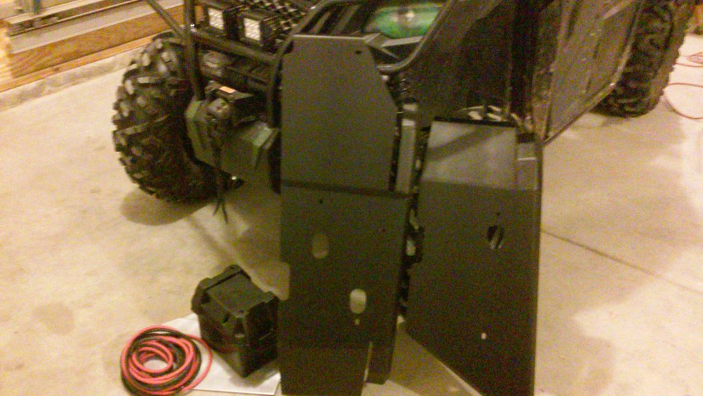

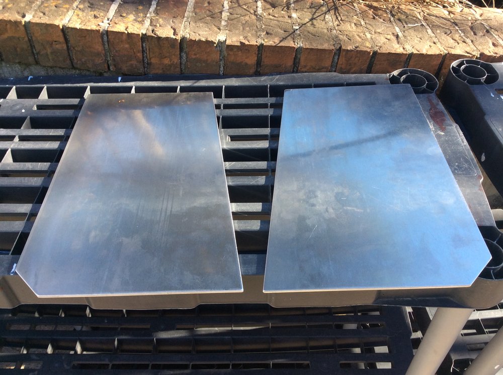

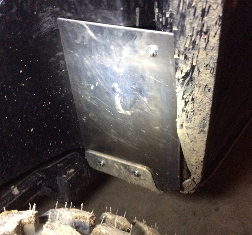

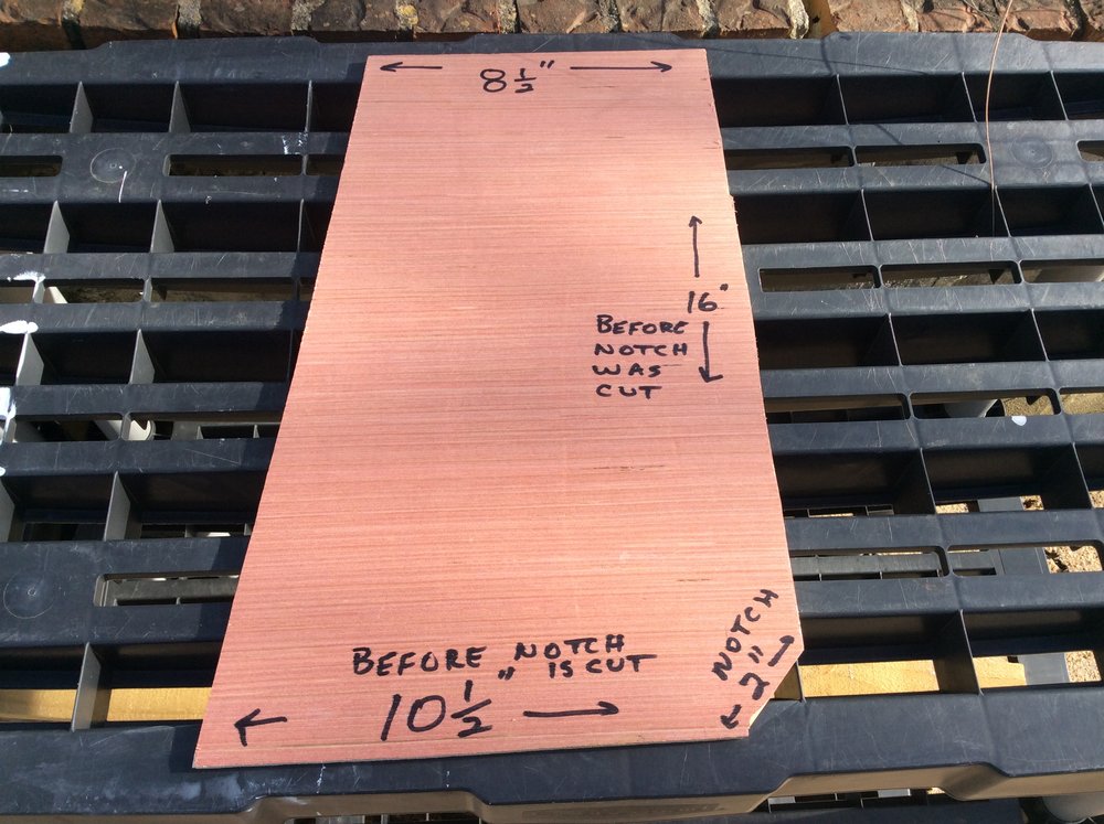

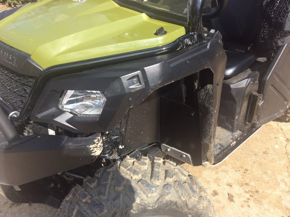

Installed and trail tested. Two aluminum plates, now painted. drilled and tapped plates to rock sliders, j hook to frame at the top outside frame.

I would imagine you could attach a strip of plastic or rubber to the outside of the aluminum sheeting to make a "mud flap" to keep your door clean. Looks good. I might be interested.

Yes, he is good to work with, and you can't be that price! Nice addition, I did trim a little 45 degree off the outside bottom corner on a final fit. Still able to wash mud out the gap on the outside frame. Wonder if anyone else has gotten them?

Looking forward to a pic of the anodized plates.
22,587
34,173
  5. Talon x4
Will do, when I get them. It said that colors would take longer, so I wait...

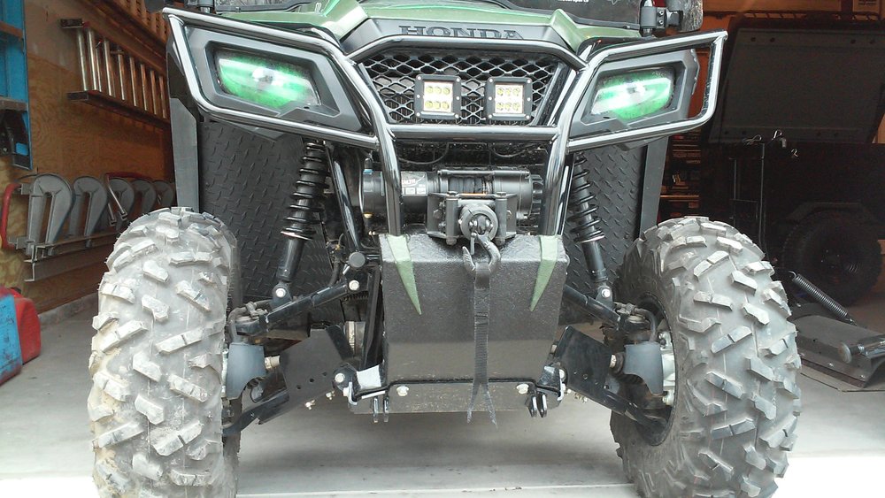

Rock Sliders were delivered today and got them installed. Driver's side was cake, passenger side was a pita. Seemed like it was slightly bowed down in the middle and the bolt didn't want to bite. I jacked it up and got it to work.
I thought these things would be somewhat flimsy until bolted on, they're solid, 3/16" thick aluminum.
Black anodized...BA!

Lookin sharp! Almost too purdy to take on the trail lol

Had a similar problem with one bolt getting bite, would have been easier if all bolts were the same longer size. Black anodized does look good, worth the wait! Had some spare metal and going to add these to the inside curve of the wheel well pieces.
Yeah, I cussed about longer bolts more than once. Placement of the one finger hole could've been better located as well.
They did send those two extra pieces for the wheel wells. Not anodized, just raw aluminum. Pretty thick stuff, which got me thinking, I have thinner diamond plate that would roll right around that wheel well...

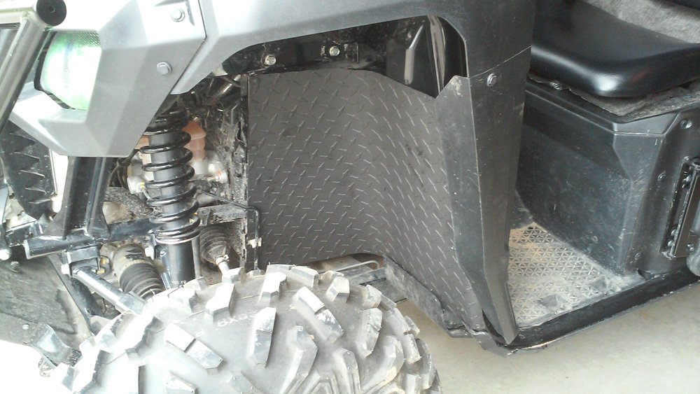

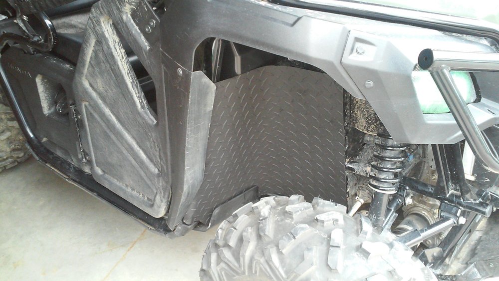

Only screwed to steel, no plastic. Only wrapped what has plastic behind it, didn't want the hollow tin can sound. Tucked in behind Ricochet's at bottom and peened them over about a quarter of the way around the roll bar. Not the thickest aluminum but it'll help.
View attachment 40534 View attachment 40535 View attachment 40536
Now that's the ticket, seems like it would be a hot item if someone sold these! Maybe you can use those other plates as a base around the 2nd battery?? Looks good with the black rocksliders. Looks like a green eyed monster.
