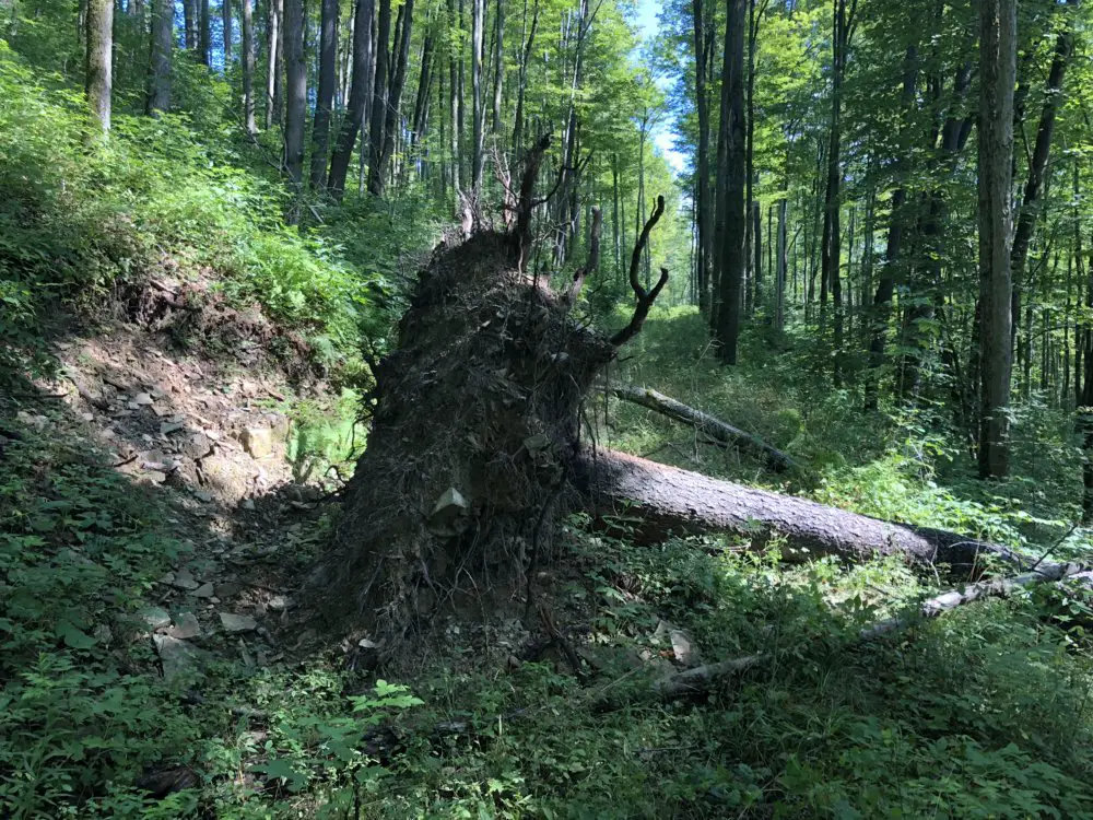

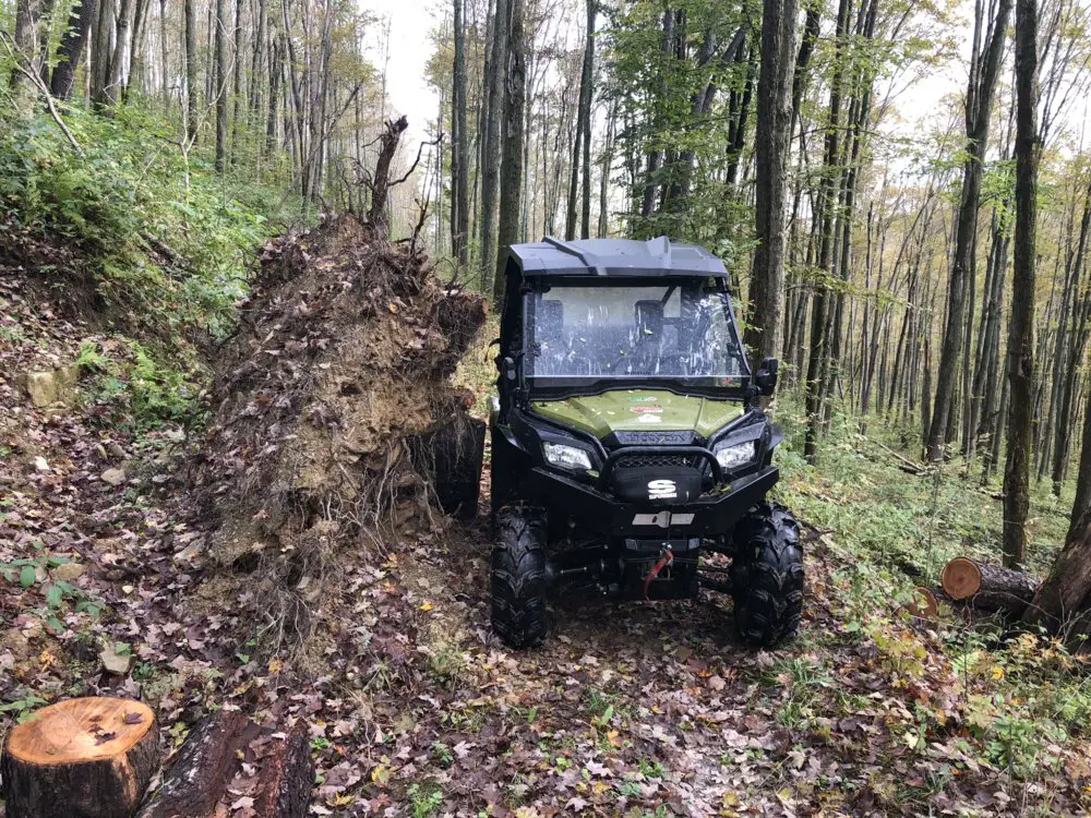

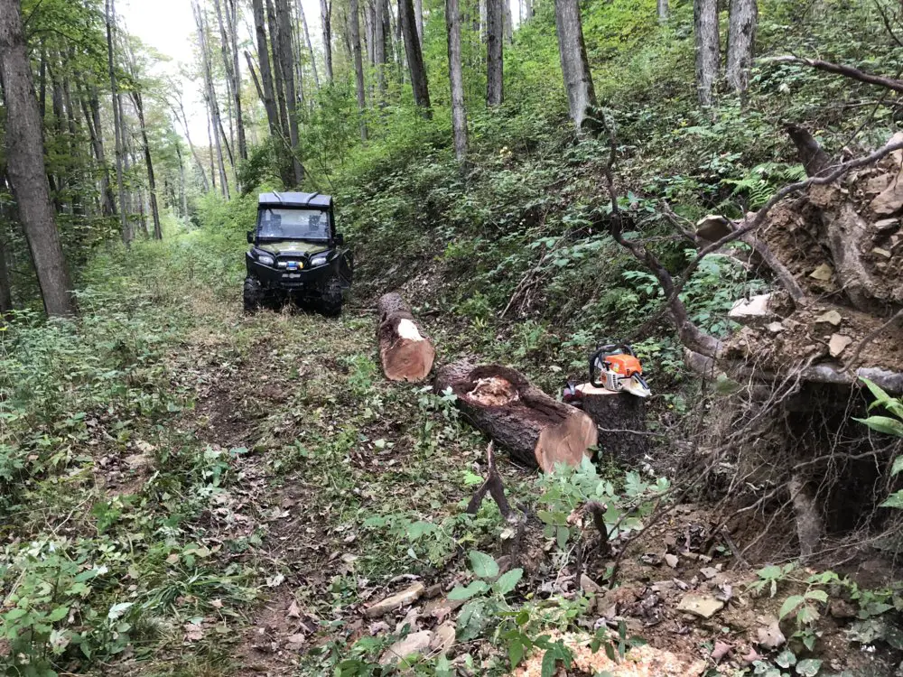

I had to clear a logging road to a ladder stand early last fall. All I had with me was my chainsaw and P5 with the Terra 35 which I had changed the cable to the 3/16 rope. I had to winch some log up over a fairly steep bank. While winching and stomping the brake pedal with all l had, it was skidding the P5 toward the log, but at the same time, the log was coming. At one time while winching,I reached over to close the door, but it wouldn’t latch due to the frame bowing. The winch was trying to pick the back wheels off the ground! Just amazed me how strong the winch and little rope is! Wish l had video, but l was alone.
