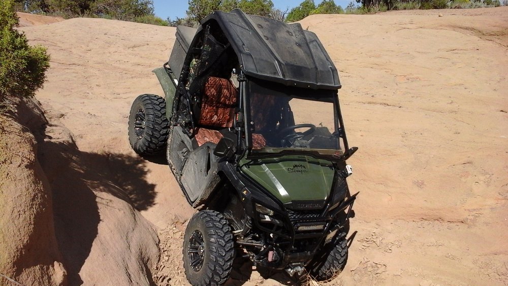

Found stuff that is used to re- face..your
dashboard..stuck on outside top..
helps some.

Is that stuff transparent or solid?
Solid...Black...
not a fix ..all
Helps some...does not
fair well...to sun.
My 2nd application. ..1st
one lasted 2 yrs..got brittle
so replaced..
here's a pic.. showing solid black
looking out..
20170504 191053
