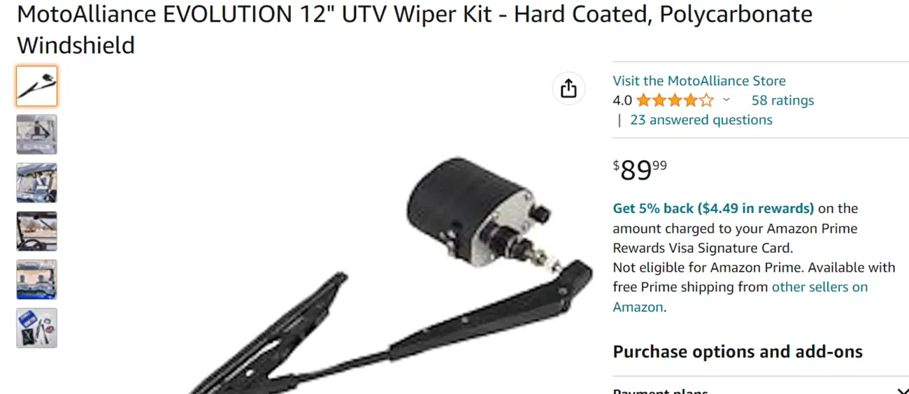

Thanks all. Yes, found an electric wiper on Amazon for 90 bucks, but it doesn't sound like my poly windshield will hold up. I have not had any luck locating an OEM Honda glass anywhere. If nothing online, I guess I am heading to a dealership to get ripped.

I didn't wnat to multi-task while I drove so I ordered this.
But it will require an addition 5-600 investment as it will quickly destroy my 2-piece windshield.
Now, I am considering the manual one as I don't plan on using it often. It would normally be used in good weather.
This is to make it street legal in NC so an RV resort in SC will allow me use it on their property. It is huge. They rent hundreds of golf carts. As of 3 years ago, it was $60/day. I can also run to Walmart, drug store and several restaurants with the SXS. This makes my SXS a dingy for my motorhome. We would use Uber when needed. This saves us from buyig $2500 worth of flat tow bars and a car.
I already have a trailer. The SXS has DOT tires, back up lights and side mirrors so I am thinking that 500-$1000 gets me a dingy while traveling to the coast.

Was intrigued about this wiper till i read the reviews. 80% said it was weak and either the spring wasn't strong enough to hold it to the windshield, it broke after first use or the swiping rage wasnt very big. Prob why there was a used one on there for $69.
Would be interesting to hear your extensive review after you had it for a while in regular use. Would be nice for those reviews to be 💩 cuz I like the idea and price.
But there were far too many of the same issues.

Thanks I normally do read the reviews so I may reconsider. It was $149 when I found it with good reviews on another web site. . I may just do the manual and live with it. My plexi split window might survive a while longer. Wish I could use rain-x on it and partly why I was going to glass. But I do love my split window giving me the option.
