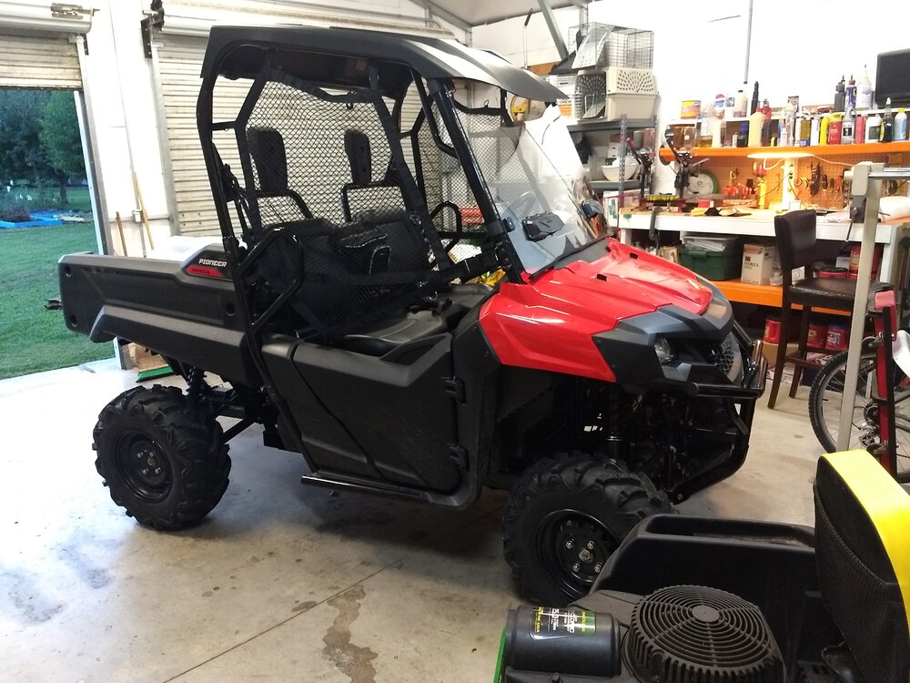

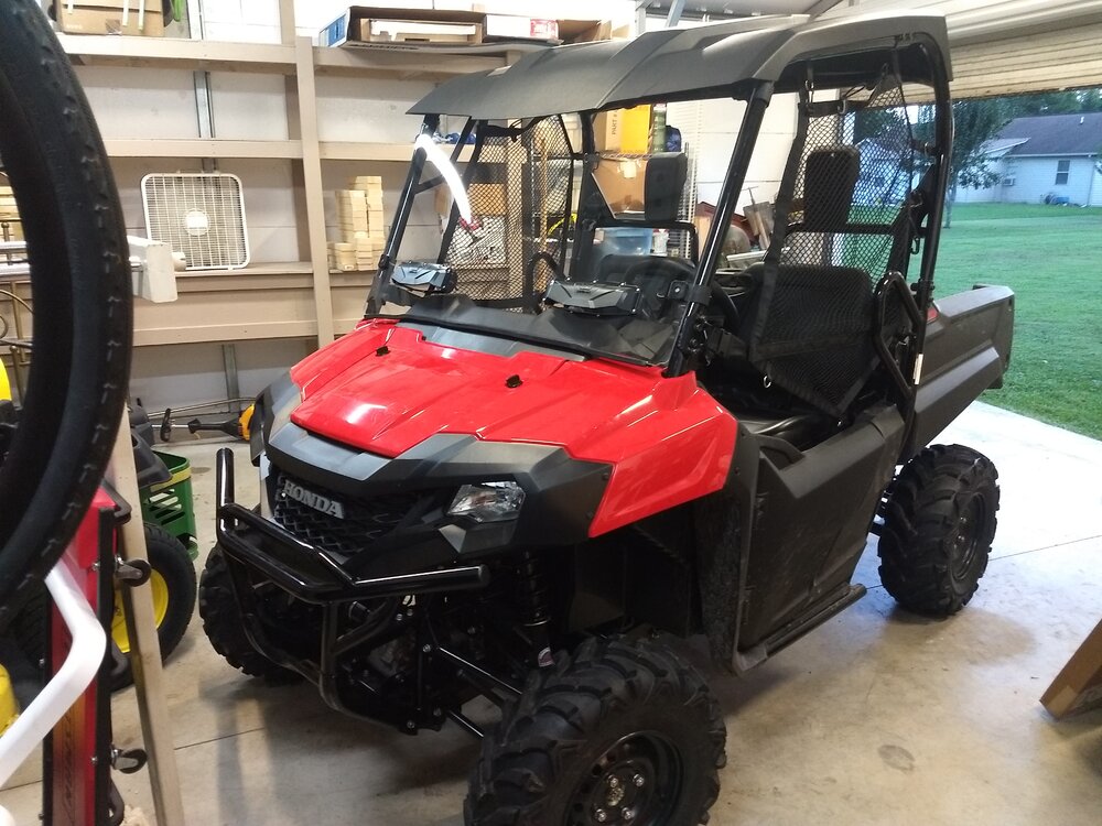

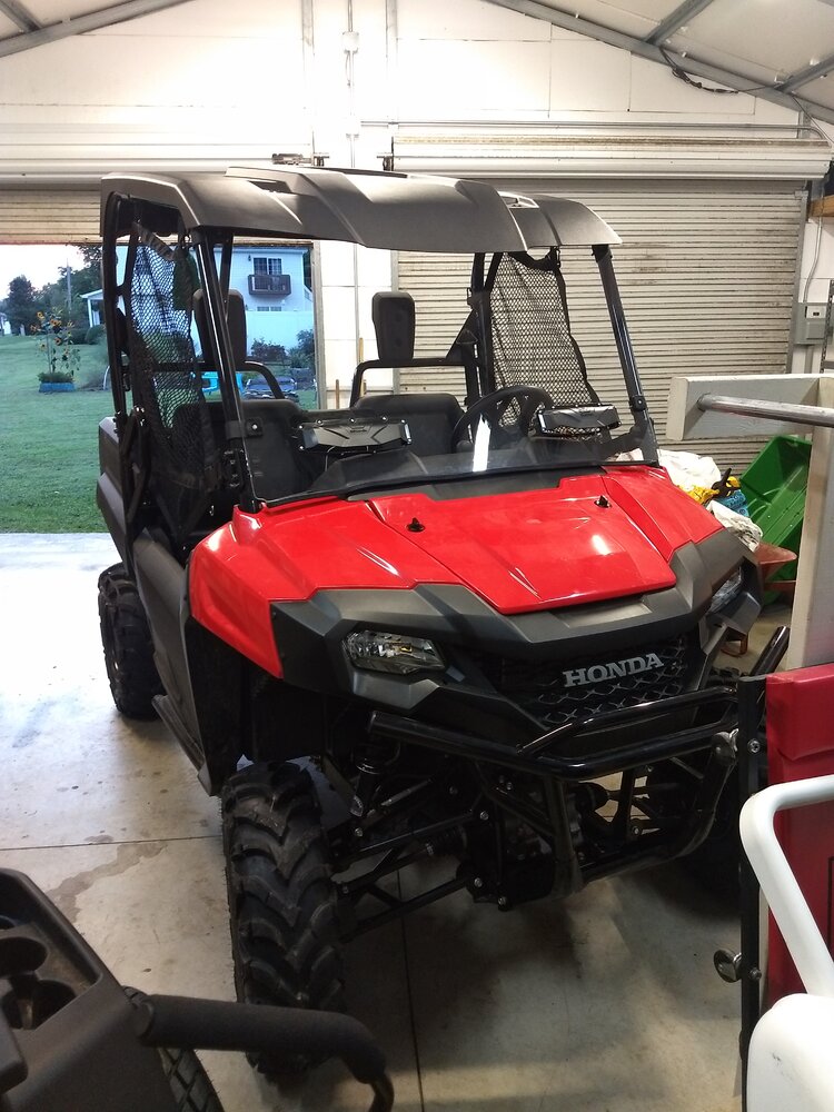

Don't mind at all. The windshield is full. It's a Seizmik vented windshield with a Honda OEM roof. The venting can be controlled. Bought both at the local dealer where I bought the machine.
Both were relatively easy installs.
