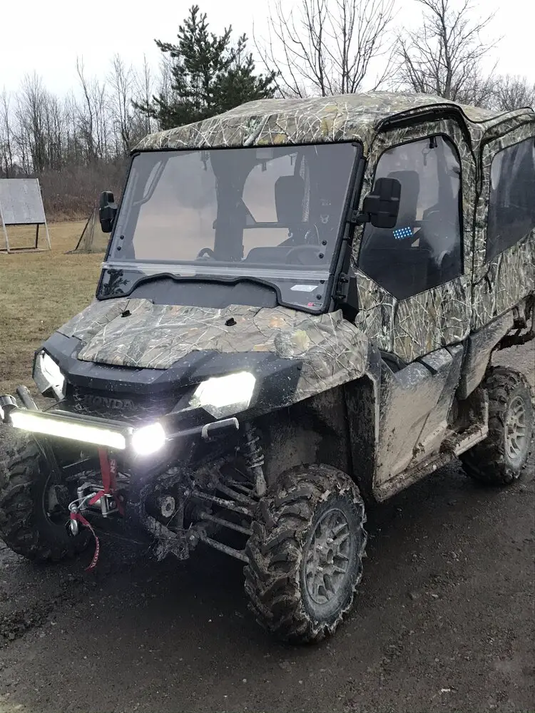

Blackwaters are nice and not near as heavy. They will be my next tire. My current tires are 29lbs. Black waters are close. I pull mine like stockers and I'm sure yours does as well.
I can tell a difference going up hills with 3 passengers. The 28x10 are supposedly 32 pounds. Same as 27x11.

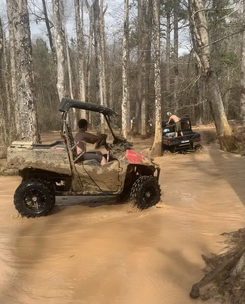

I run 28-9-14’s swamp lites. 29lbs and I have no issues

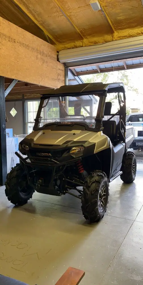

How’s the clearance on those? I’ve been looking at the 28” zillas for my 700-4 deluxe
No clearance issues with the 27s. I think you would be fine to clear 28s. The only concerns I would have is the front tires clearing when turning and if they clear bumps when driving at higher speeds. I would up switching from the 27" zillas to 27" bighorns. I love them, but they have bumped the frame bar a time or two when hitting a pothole at speed.
