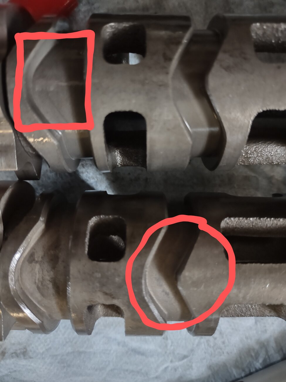

Also on a interesting note if you blow up the picture the measurements I done with calibers are the same but the 2022 shift drum that they shipped me the shape is more defined than my 2020 drum?
Do you think it's just different batch?
Or are my eyes fooling me?

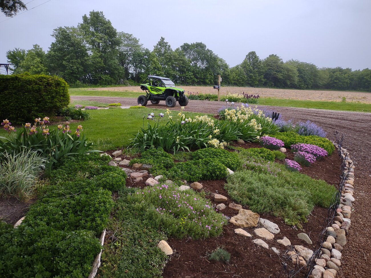

I thought I finally have a update Thanks to HondaTech and Honda of Fairfield I got the sub transmission gear I was waiting on to push forward with this project!!!! It has been sitting behind the garage ever since the last post getting mowed around but generally being in the way.
Here is a good shot of it and my wife's landscaping that's how far I got with it on it's test run until it died.
I put a DCR reground cam in it in the process DCR pressed the cam gear mount off to remove the decompressors and when he pressed it back on it no longer fit tight enough and it turned on the cam enough it would no longer run so I took the cam out pressed it off peened the cam with a punch and put it back in but turned again so it needs to be tig welded witch I don't do, mig welding I am in but I never had or learned the art of tig welding.
So it got pulled out back so it wasn't tore apart in the wife's bay in the garage 😜
