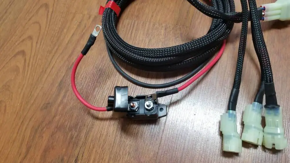

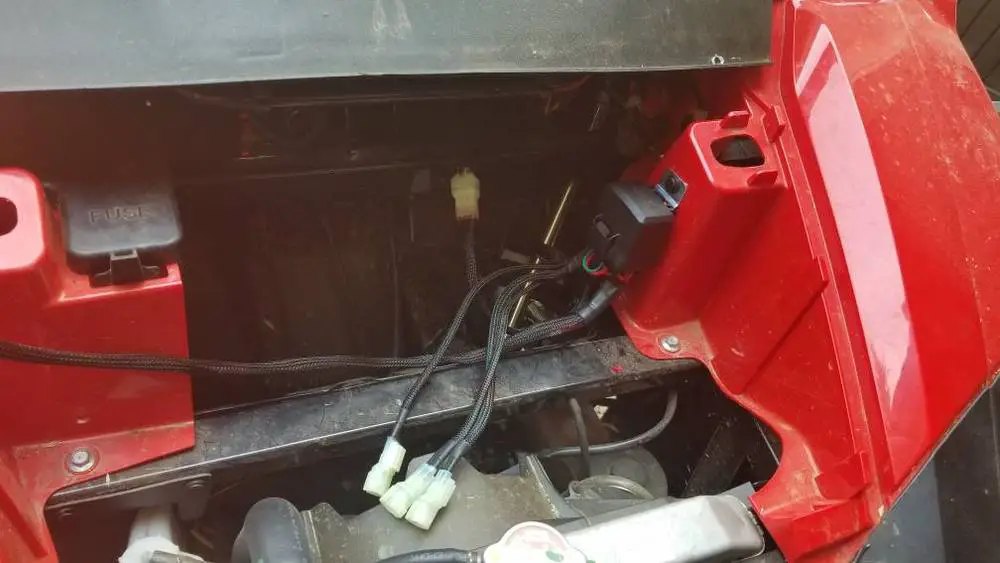

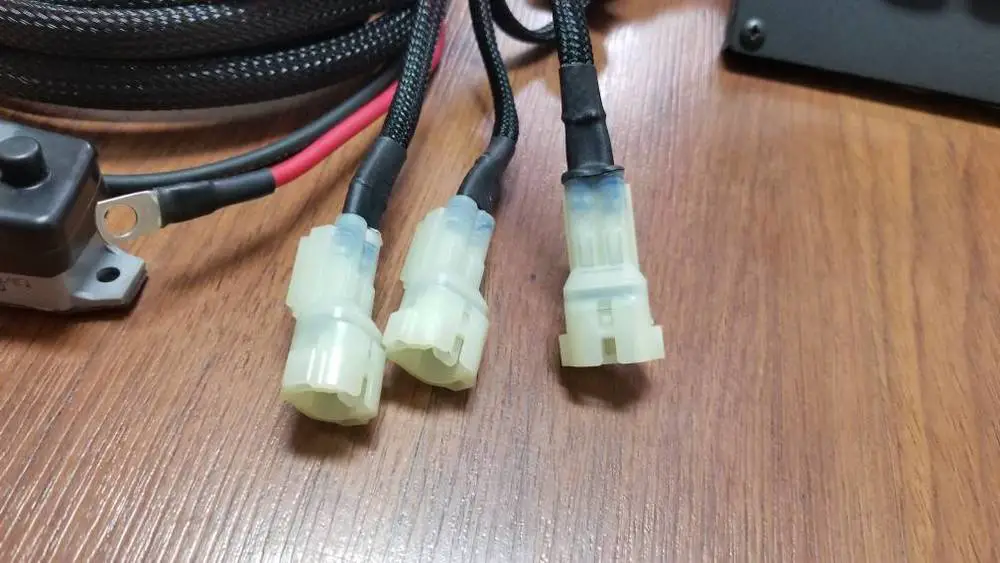

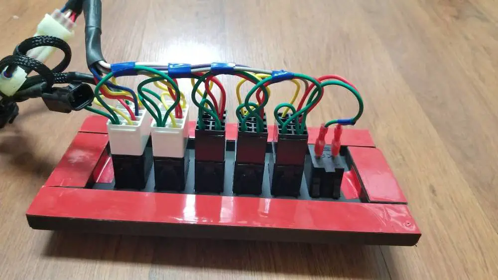

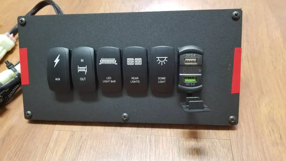

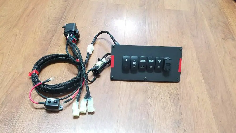

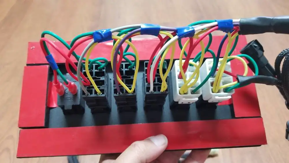

Finished up a custom switch panel for a client this week.
100% drop in ready super clean setup.
Literally just hook it to the battery and its ready.

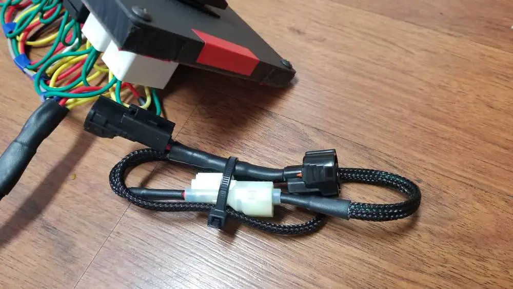

This is a 3 accessory system. 4th circut powers the panel so it can be indipendant of the OEM system.
6 spot panel using 4, 20A circuits.
- Panel power Key-on or on demand.
- Winch
- Front LED
- Rear LED
- Dome light
- USB/ Voltmeter.
Fully independent or Key-On.
Volt meter will display the selected source. Ex, if control box is connected to second battery it will display second battery upon ON or primary battery if set to Key-on.

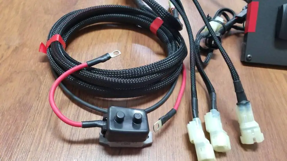

Winch has 3ft contactor control line.
Each accessory line has 12g wires.
Main lines are 8G.
50A main resettable circuit breaker.
Relay control lines 18g.
Panel riser was required for Pioneer 700 models 2017+ as shown with the red tape.
- Winch
- Front LED
- Rear LED
- Dome light
- USB/ Voltmeter.
Main lines are 8G.
