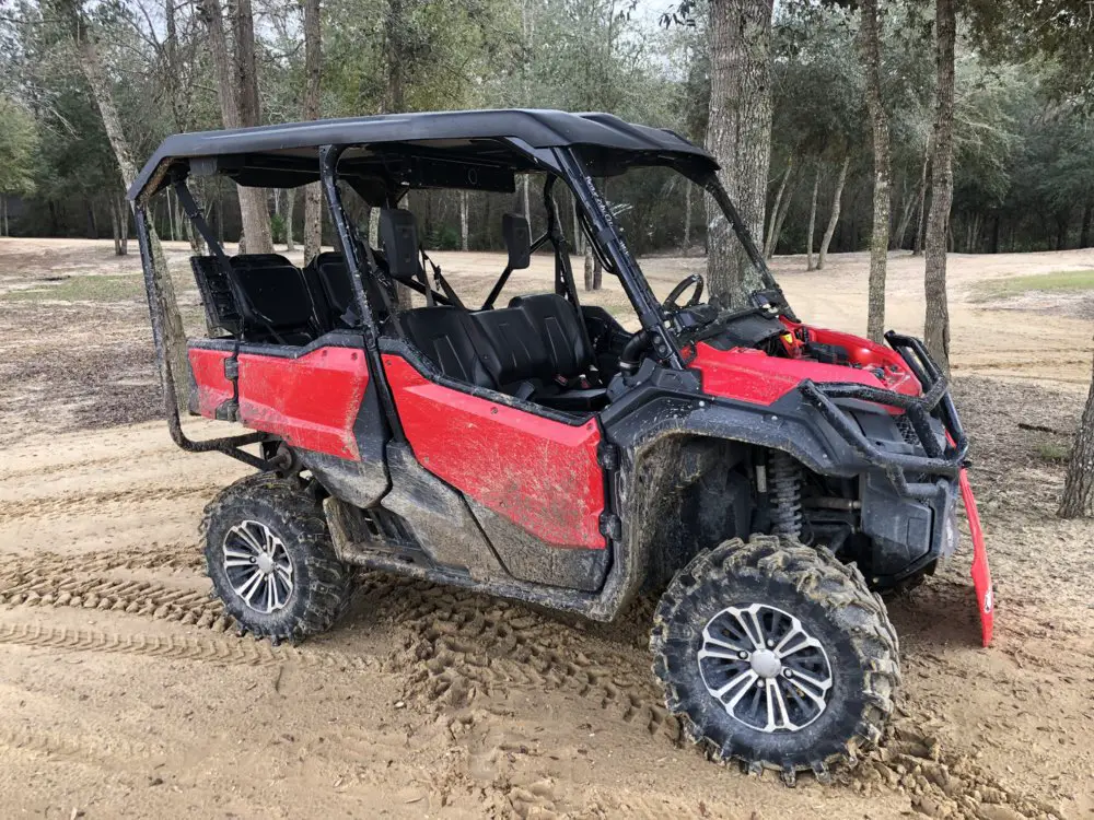

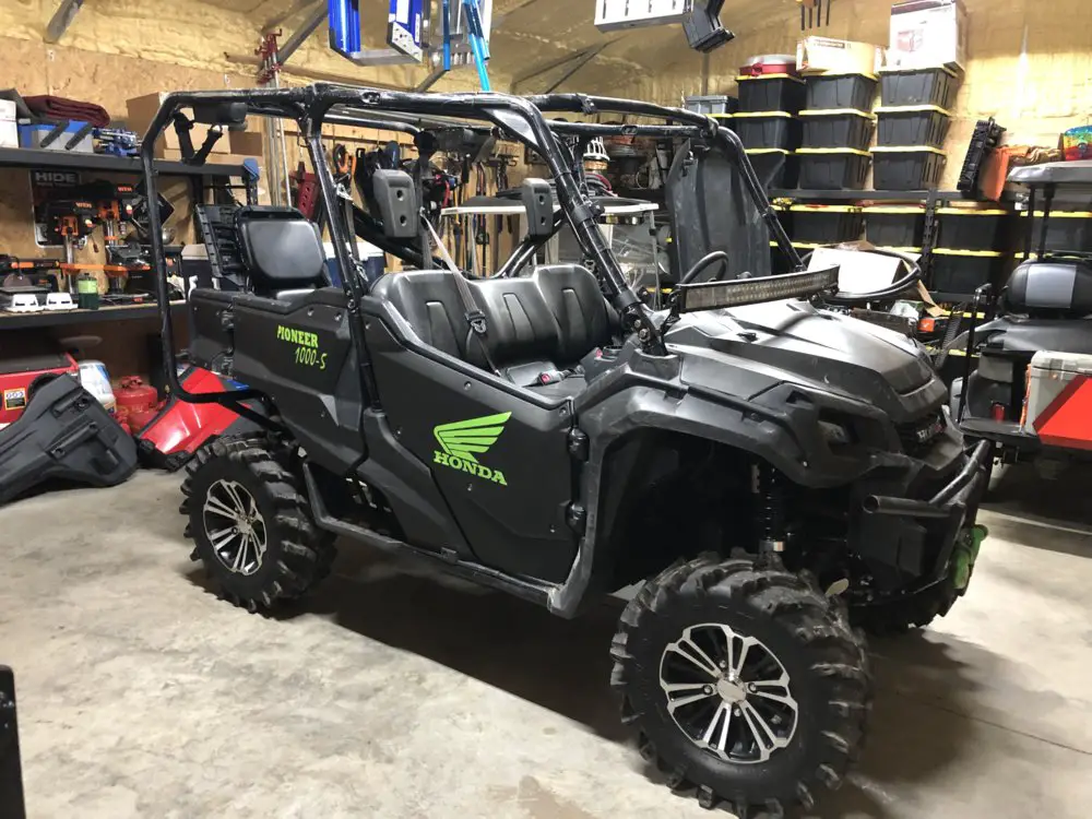

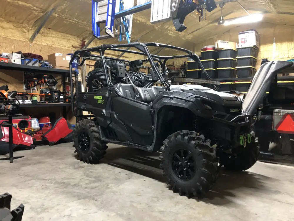

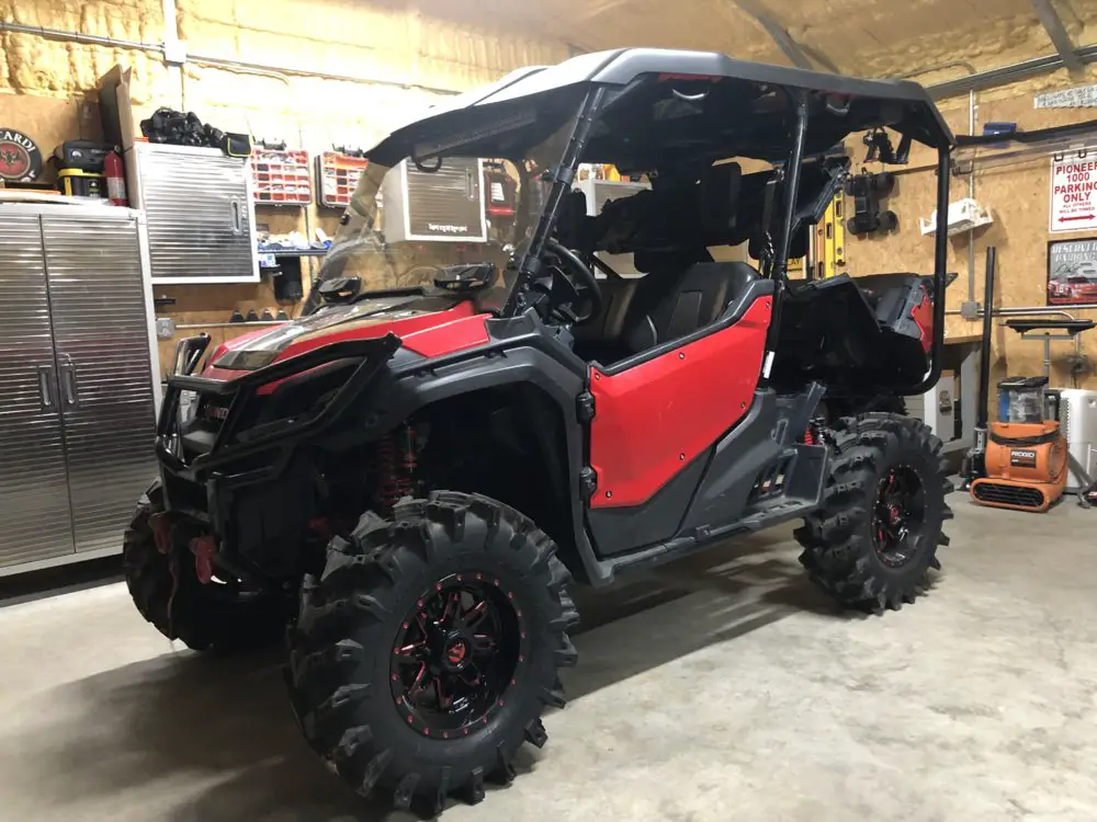

Hey maybe he’s on to something. We definitely take ours to the spa and no issues :D
