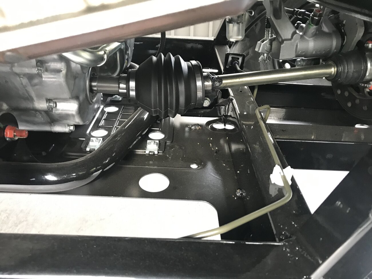

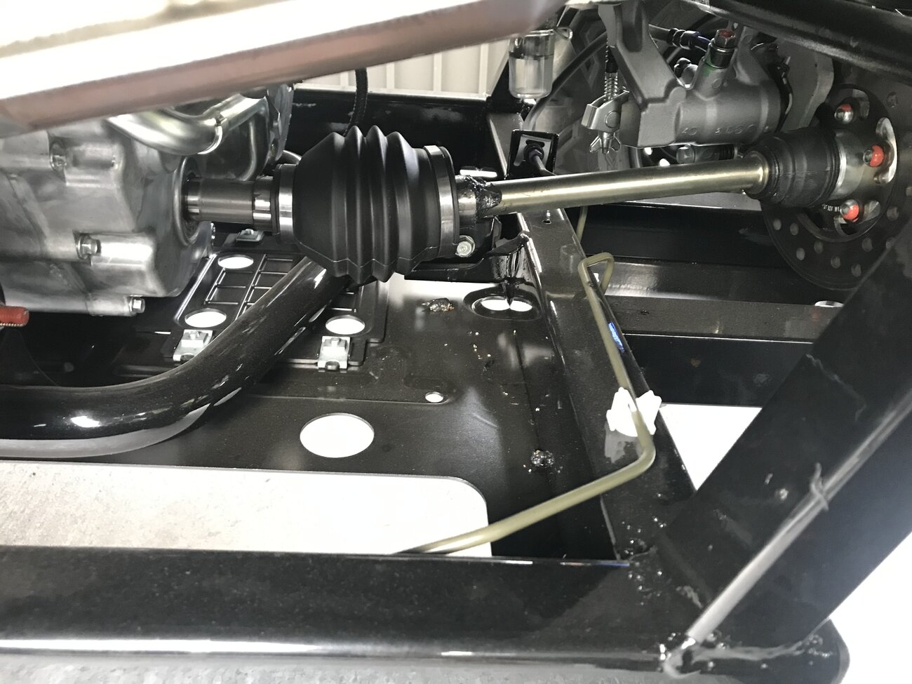

Brand new P700 has grease pushed out on rear part of mid drive shaft after 10 hours running.
Is this normal from packed grease?
I have not seen tear in boot appears to come from around drive shaft that has intact band around it.
Should we be concerned or is some leakage normal when new.

Try to post some pictures. It sounds like you have a band not seated correctly allowing grease to push thru
18,144
64,595
Most likely just pushed out from the assembly of the shaft. Wipe it off and be done.
The rubber boots are more just dust covers for the spline joint.
They are not meant to hold any grease and they should not be packed with it.
There will be some grease inside, but again, not packed.

Are you talking about the little boots with o rings for "clamps" on each end? Near the brake rotor on the rear?
If so, consider yourself lucky, as they typically have had very little grease in them at all.
My 1st 700 had a squeak from the front driveshaft from being dry. My 500, which has a very similar setup, developed a front shaft rattle at certain speeds that sounded like the engine was flying apart...or MORE like the engine was flying apart than normal, also from a lack of grease.
The solution to both was to do what @Hondasxs just told you not to do, IE-slip a grease needle under the boot and pump that slip joint full of grease. I went ahead and I'd this on my current 700 before issues arose...and yes, grease will leach out of them a bit. Wipe it off and forget about it as long as the boot isn't leaking.

No...not the u joint.
The plunge joints, using a grease needle. You can roll the little o rings off and pull the little boot back and get a grease needle in in them and around that big rubber plunger thing.

It is from the drive shaft.
Some dropped off below.
