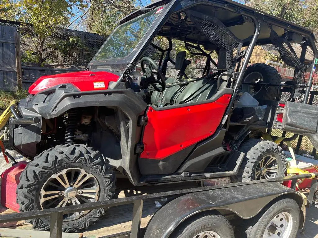

I run 28" Big Horn II's on 14" 5+2 wheels. I have the 1" @RB3offroad spacers on the rear because I like the track width front to rear to be close. I have 11" tires in the rear and 9" on the front and no spare ever.
