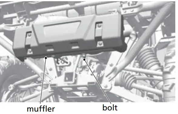

Where is the spark arrestor on the 22 models. My 1 wrench came on today. It doesn't have the removable tip like most.
18,106
64,288
Ok... Figured it out.
Honda has digressed back to the year 1999, Just like the headlights.
And just in case you cant find it, they have clearly marked the "muffler" for your convenience.
1.Select a well-ventilated area free of combustible materials and make sure the exhaust pipe is cool.
2.Remove the bolt.
3.Start the engine and rev it up approximately twenty times while momentarily creating exhaust system back pressure by blocking the end of the muffler with a shop towel.
4.Stop the engine and allow the exhaust pipe to cool.
5.Reinstall the bolt securely
