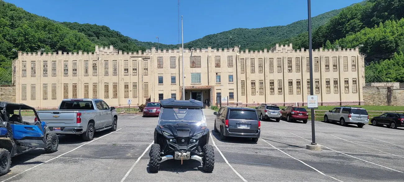

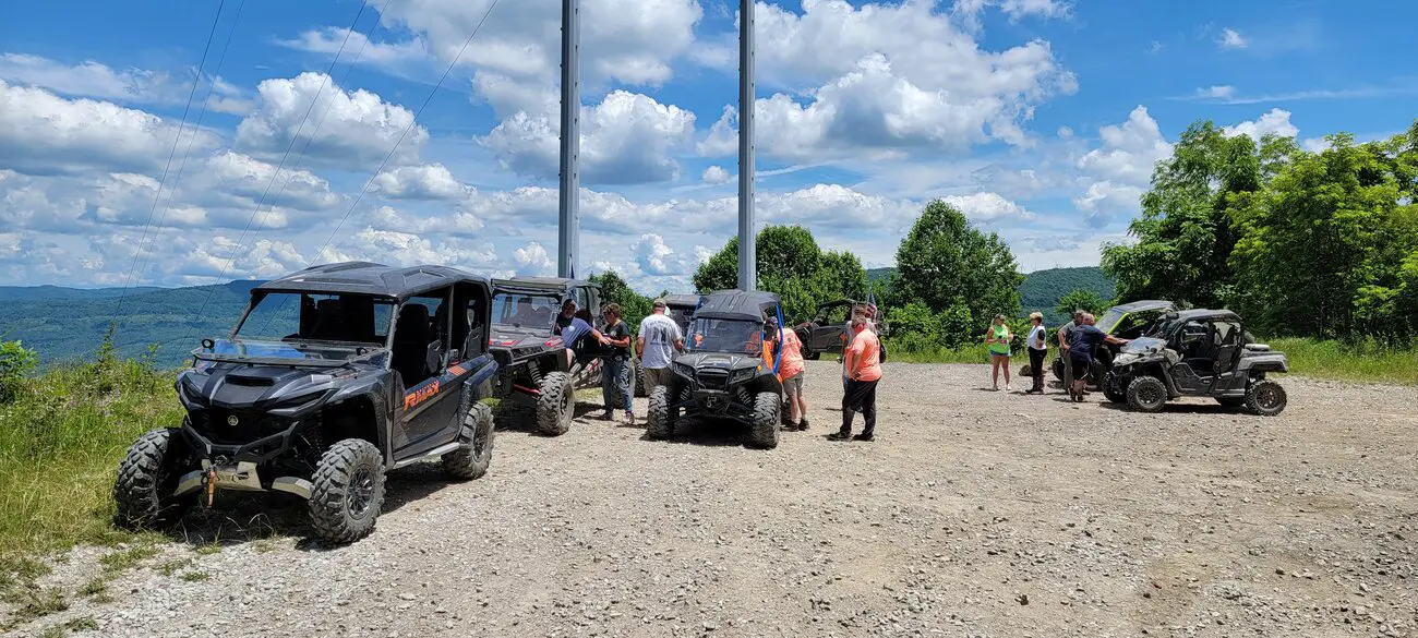

Taking a private group to Brushy Mountain Pennitentiary this Friday, that will be 120 miles for me and will be a better estimate with 70 miles of easy cruising and 50 miles of average trails.
Great ride with neighbors today. Note I had 4 people in the machine for about 8 hours, the two riding in back seats commented how surprisingly comfortable it was all day from seat quality, ride comfort, and no heat transfer from engine compartment. I only noticed the bottom portions of cup holders getting pretty warm as I had a stainless tumbler in it all day, cup holders are directly over engine in front and back.

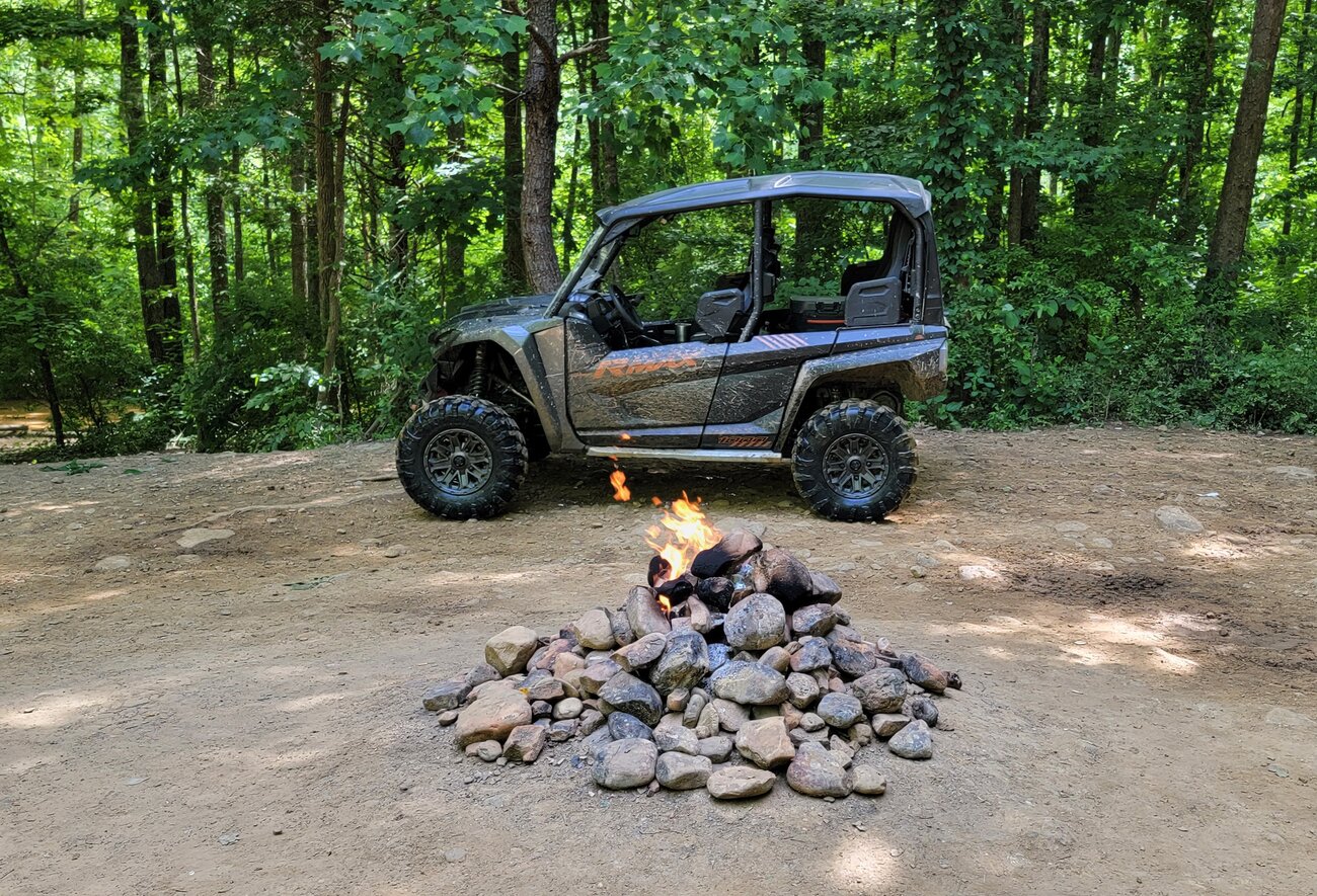

On Monday (Memorial Day) wife wanted to go for a ride since she missed out the day before. Her, I and the pooch covered 107 miles in Royal Blue and New River Units. at the end filled up with 7.0 gal. We were on our last bar according to fuel gauge for last 30 miles, but it wasn't blinking. (manual says 2 gal left approx. when last bar starts blinking). So we had 2.5 gal of 9.5 gal left after 107 miles, good info to know.

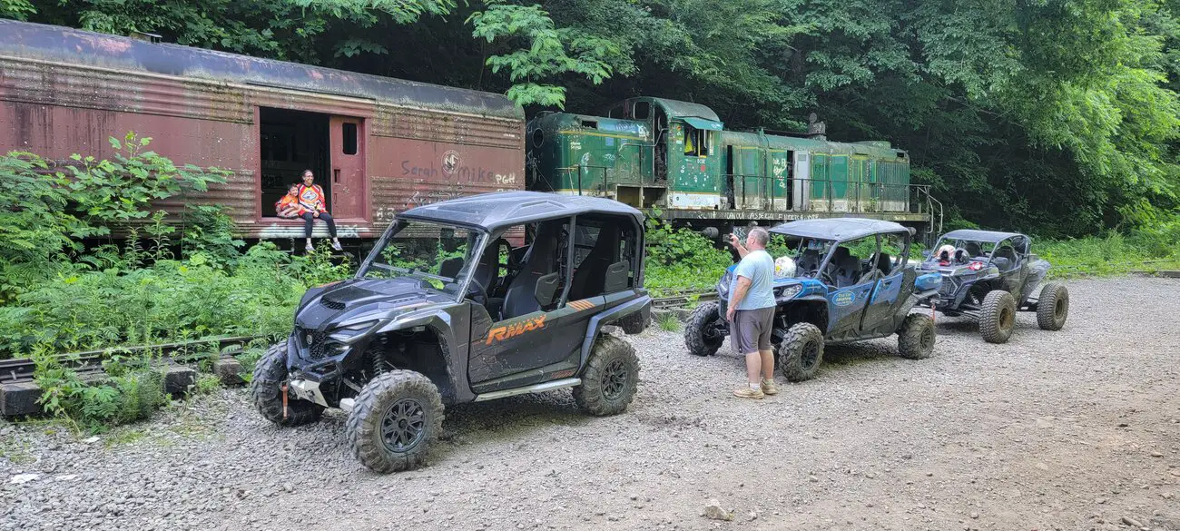

Took machine out Monday guided a small group to the Train, Prison, Flame, etc. all good with 600 miles on it. One thing I did learn on last 2 trips was to use the CRAWL mode on the trail, by changing the throttle by wire mapping considerably from the TRAIL & SPORT settings, the machine doesn't run as high an RPM while cruising slow on hard trails, uphill or mud all bets are off. Still though found a happy medium with the engine rpms / noise at trail speeds.
