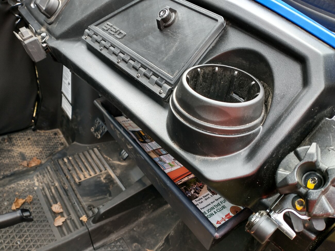

As noted in the photo above, for storage I added a Bar Maid CR-760 tray under the dashboard. It is 3 x 5 x 14 and has a drain hole in the middle of it. To secure it, I epoxied some OSF boards under the dashboard. There are some slight bump outs on the firewall and side wall that I lined it up with. I needed to cut a small angle out on the upper left side of the tray- otherwise the lips of the tray rests on the OSF for added support. Then I just used a few 3/4 screws to affix it. It does not get in the way of the passenger knees. Not the largest but I can store stuff in it.
Note above it I have a CrossWinds locking glove compartment. Super easy to install and just right for our smartphones. Also a great choice.
Man I really like that. If its easy enough to do I will def add this to mine. Idk why honda didn't just put some storage in the cab. Seems like it would cost nothing and make it a lot more marketable.
