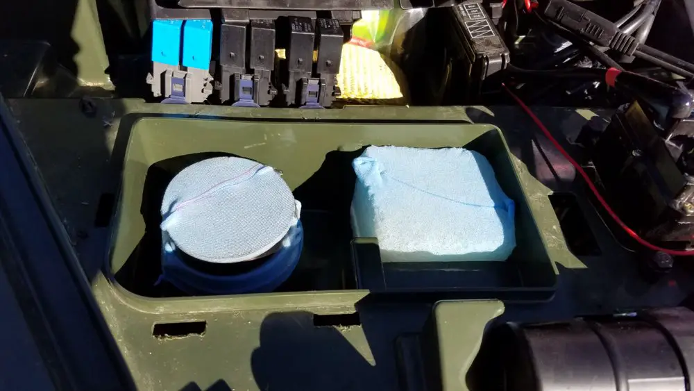

You need a new one and then put a filter skin over the intake under the hood and you can clean the filters skin instead of replacing your air filter. I use PC filter skins and then put a big hose clamp on the filter skin so it doesn't suck it in works great and then you don't have to change your air filter as often.

And you need to check all your connections that go to your air cleaner make sure none of them are loose

What filter skins are you using and where did you get them? Are you putting the skins over the stock pre filter thats under the hood?

PC Racing Filter Skins put the filter skins over the intake with a hose clamp and over the pre-filter you can use the medium size or small size . if you put it over the intake make sure you use a hose clamp otherwise it will suck it right in.

Small over intake with big hose clamp and medium over prefilter

I have a foam unifilter on my snorkle head. I've noticed it keeps the stock filter a lot easier. I bought 2 so I can swap on a clean one if I'm riding a few days in a row.
