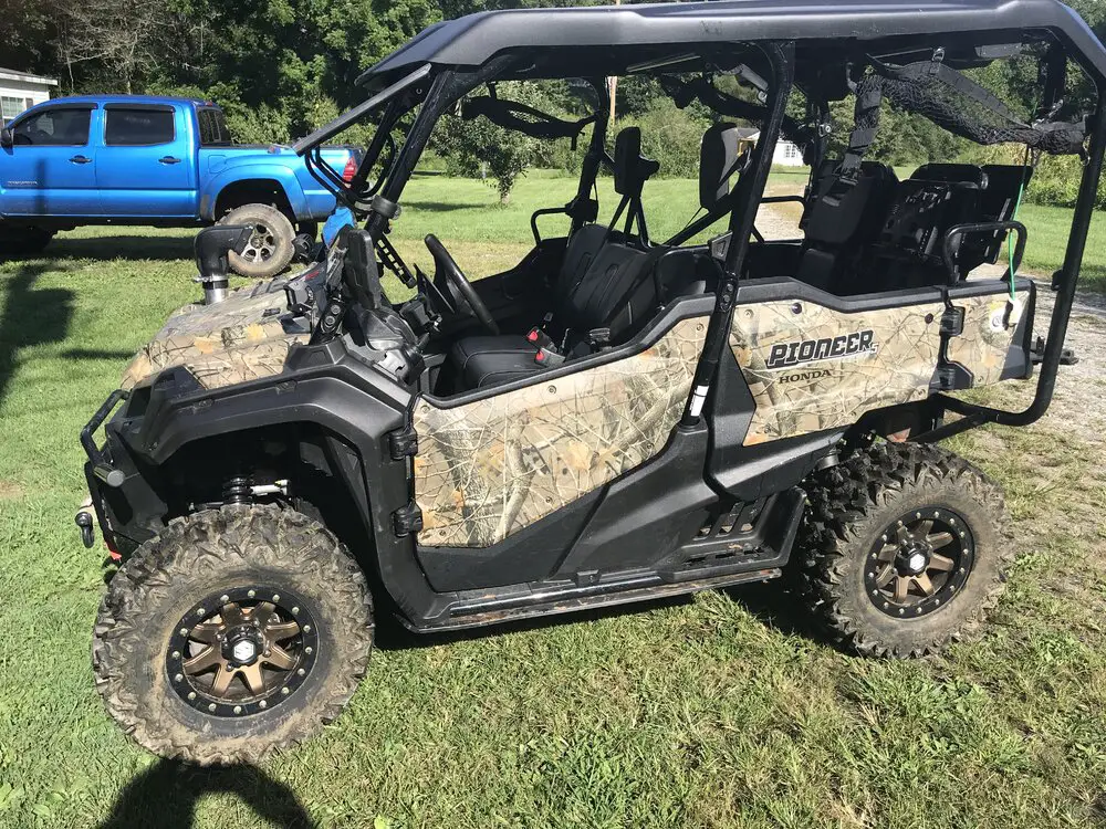

Ok, so here’s what I did... I bought 5 wheels and tire (sold the stock D Lux wheels and tires) wheels had a 5+2 offset, tires are 28 - 10- 14 with and 1 1/2” wheel spacer from @RB3offroad on the rear, after installing I gained about 2” in height and about 1 1/2” in width over stock. I do have a bit of a rub when wheel is cranked all the way and suspension is compressed, because I have the 1/2” trail armor full skid plate, but it’s not enough to bother me right now so roll on.

So the bighorns measure about 25.6 inches with 14 psi with weight on them , but off vehicle are almost true 27. (These have 200 miles on them) next to my new 28” tusk terrabites with 10psi (off vehicle ) they are barely taller. On vehicle with 10psi they measure 26.5. So for what it’s worth they are taller but not a true 28. I doubt they will rub , if they do it will only be under full compression and at that point I’ll adjust my spring preload. Now for the other three tires ....

Hard to tell from the pic but it’s for sure leaning hard on the oem side after I moved it. Sweet.
