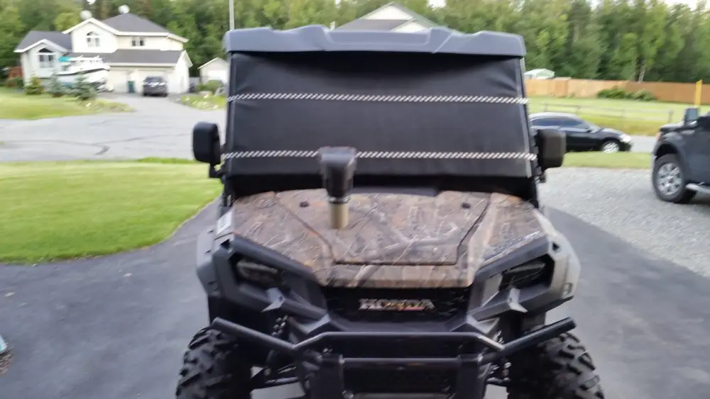

My wife made this for our P1K glass windshield. It is 1/2" foam insulation from Lowes on the inside. We bought some marine vinyl from Jo-Anns like this:
Marine Vinyl | Jo-Ann
We used a couple of tie-down straps. She sewed the whole thing together and left an opening to replace the foam if needed, which velcros shut. The straps have loops on the ends which we used bungee cords to hold it on. So far it has worked great, even doing speeds that legally aren't allowed :D
It also keeps the overnight frost off the windshield during hunting and camping trips in the fall/winter.
