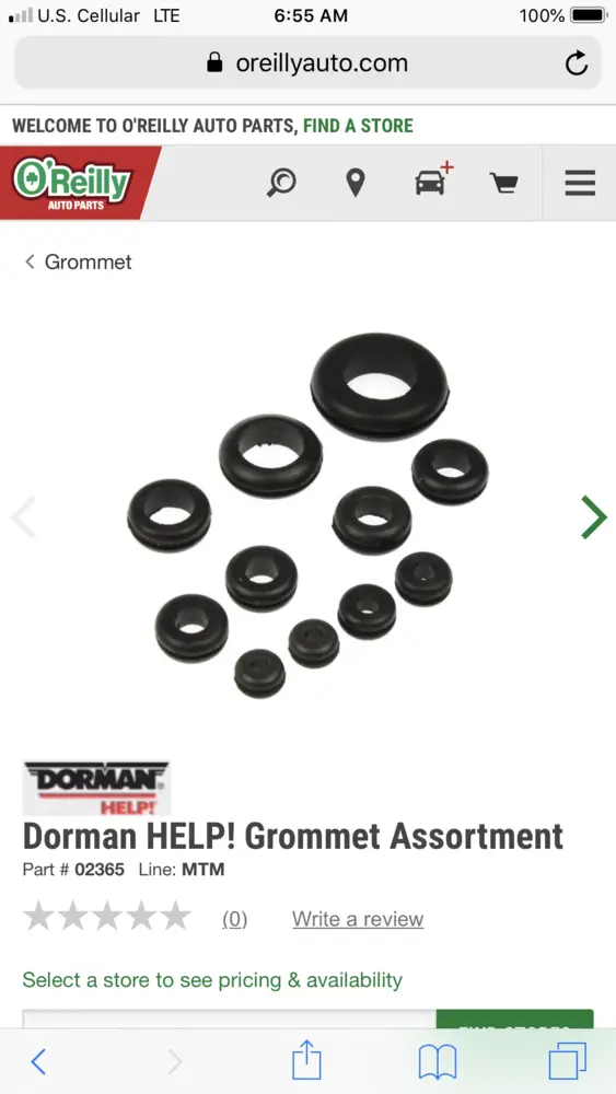

If you have an auto parts store nearby you may check there as well. O’reilly auto parts carries the dorman brand which is for auto use.
