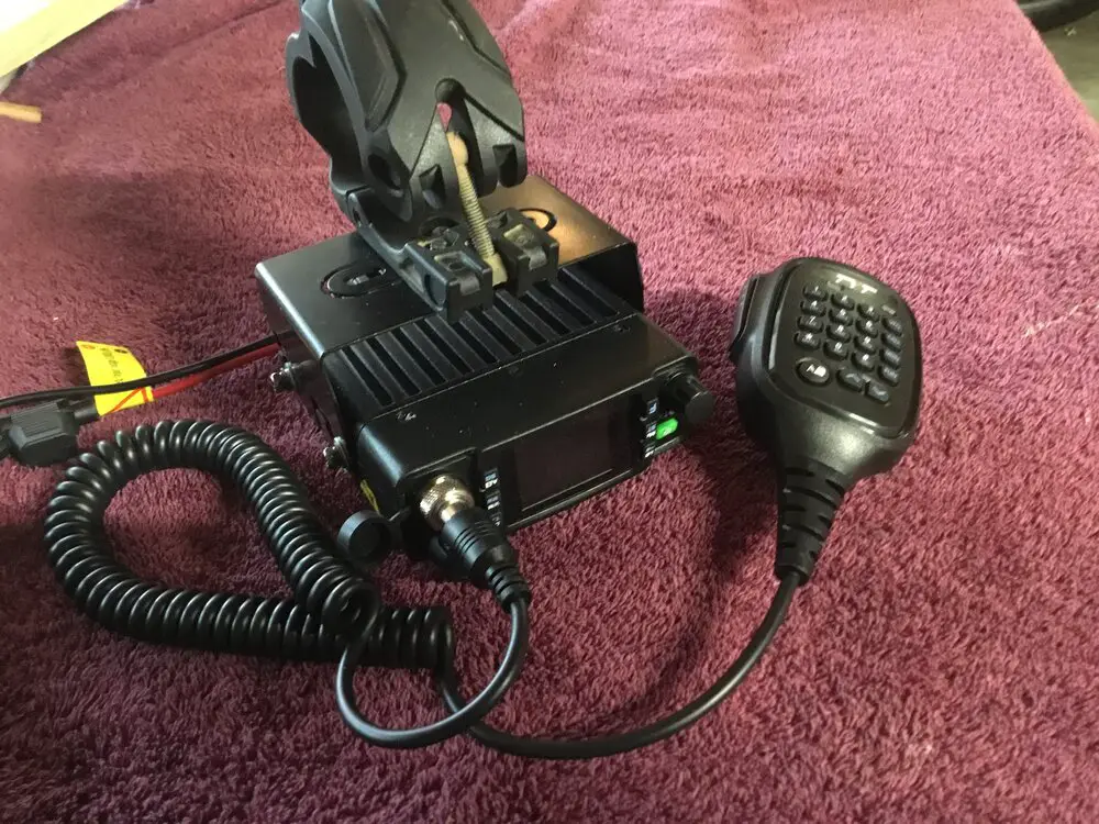

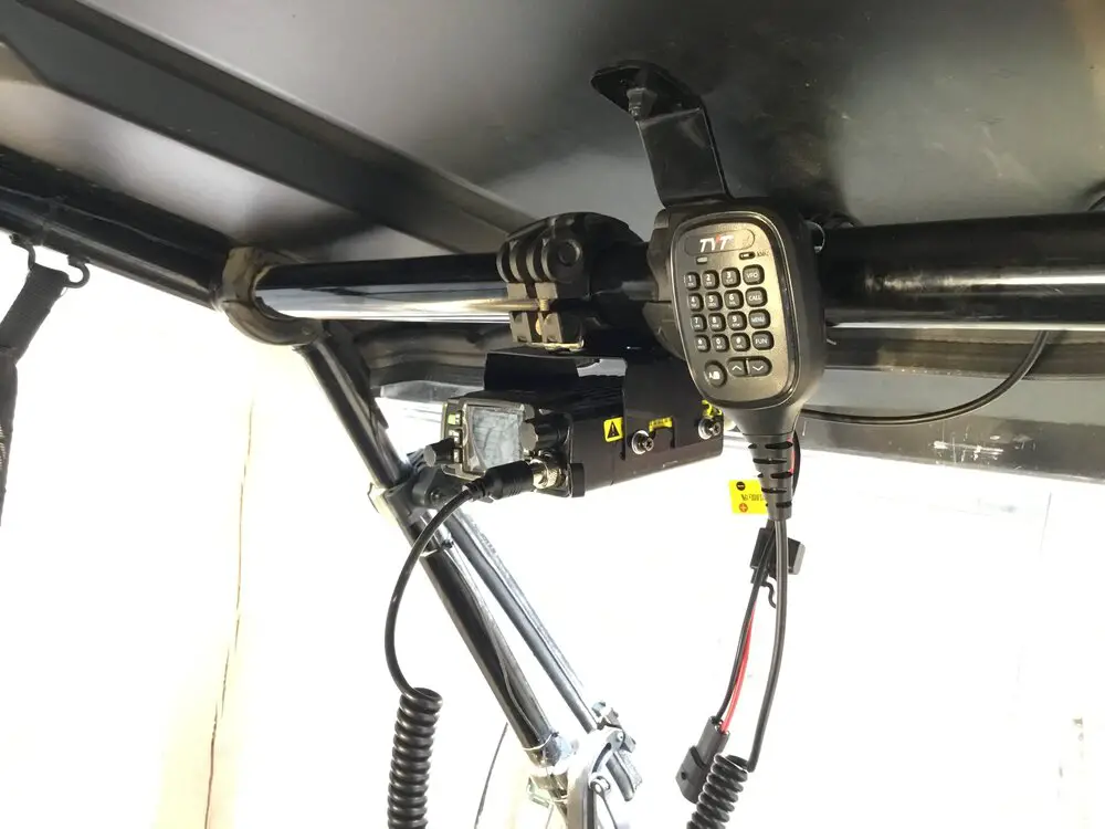

Like having a TyT 8600 installed on a Honda ROPS quick clamp. Became a HAM as a hobby so its an easy move to the house or truck. Just got an extra antenna. Automotive headlight plug 9005 fits the water proof power plug.

Recommended, three power settings, up to 25 watts (Use the lowest power that works is a good practice). Would buy again if needed. A lot of Ham quality radio for the price IMO. Never worry when spraying down the cab area.

Did you use a Stock Roof Mount clamp in this picture to mount your radio?

Yes, the P500 size, thinking is different from a P1000 diameter.
