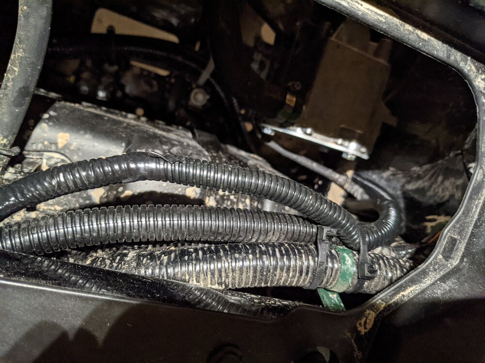

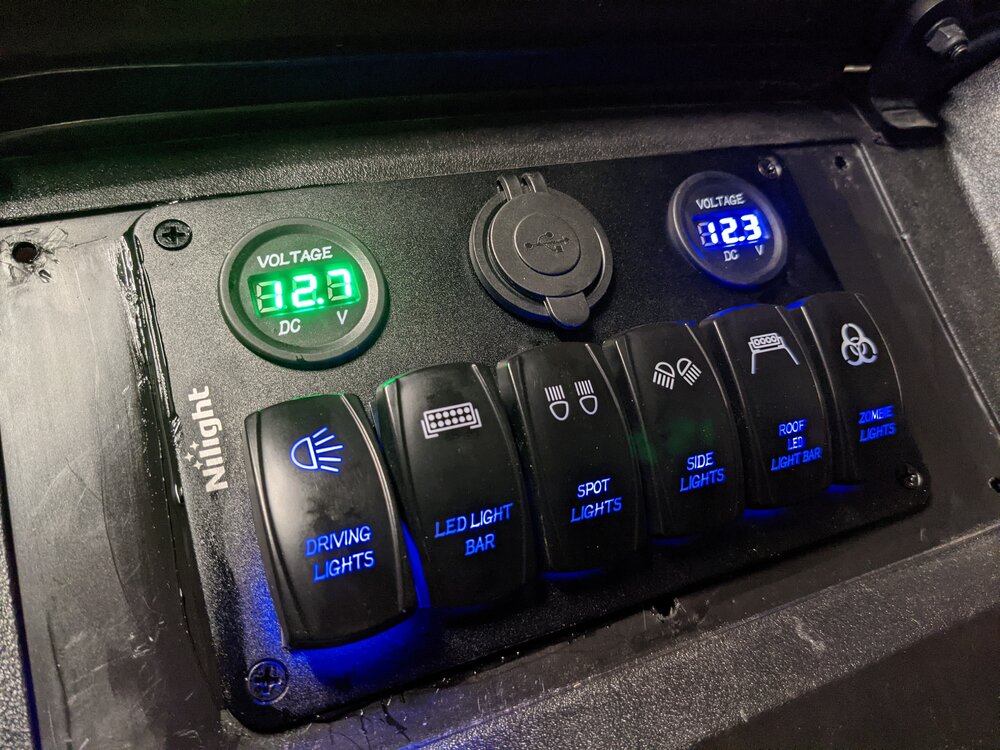

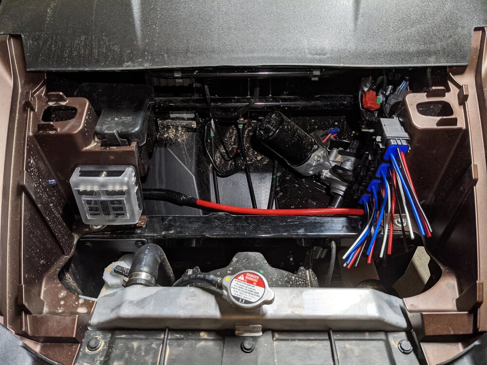

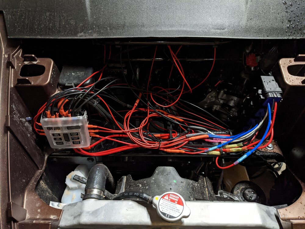

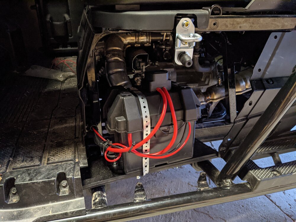

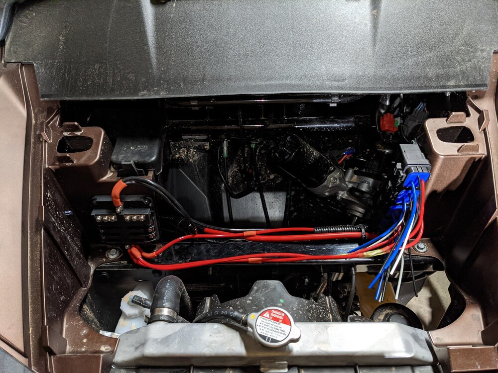

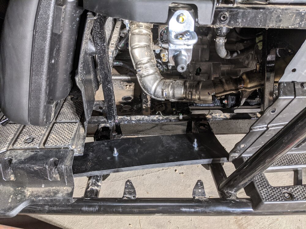

Hope this helps with some of you wondering how to do a dual battery on the pioneer 700-4 deluxe. Here are some pics of how I did it.
