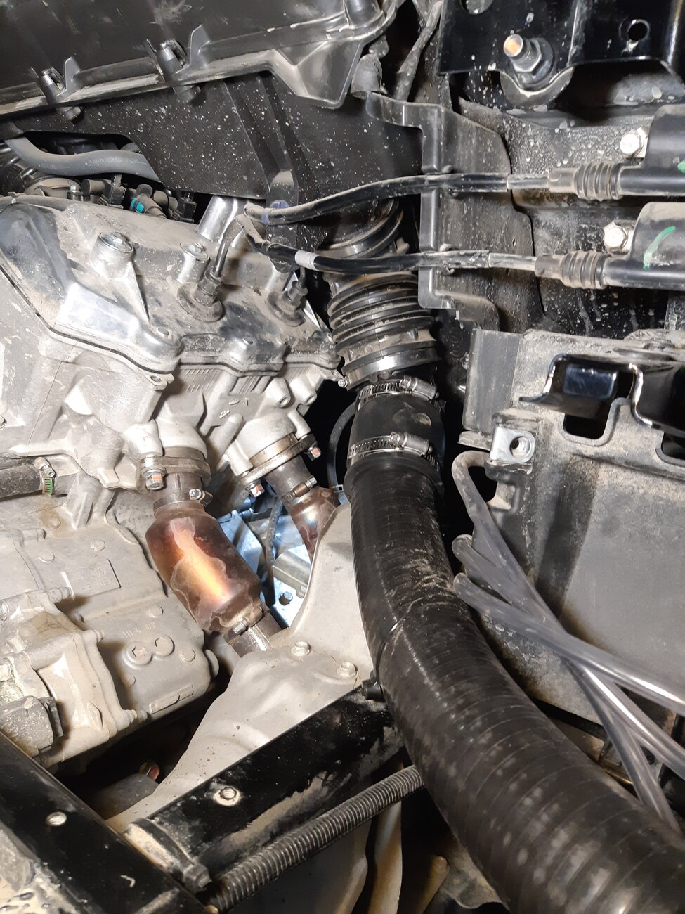

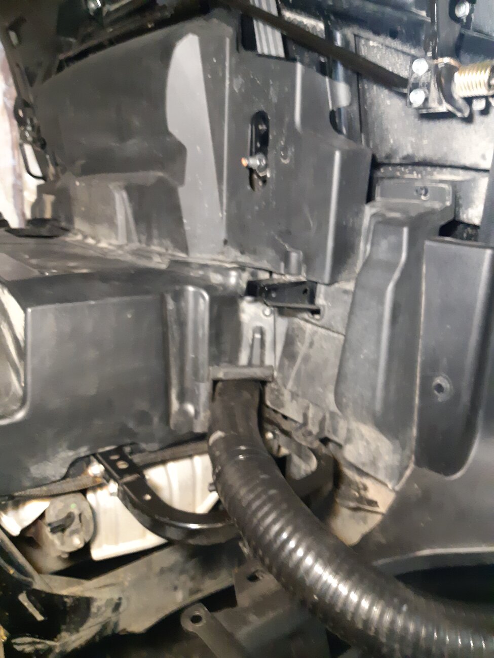

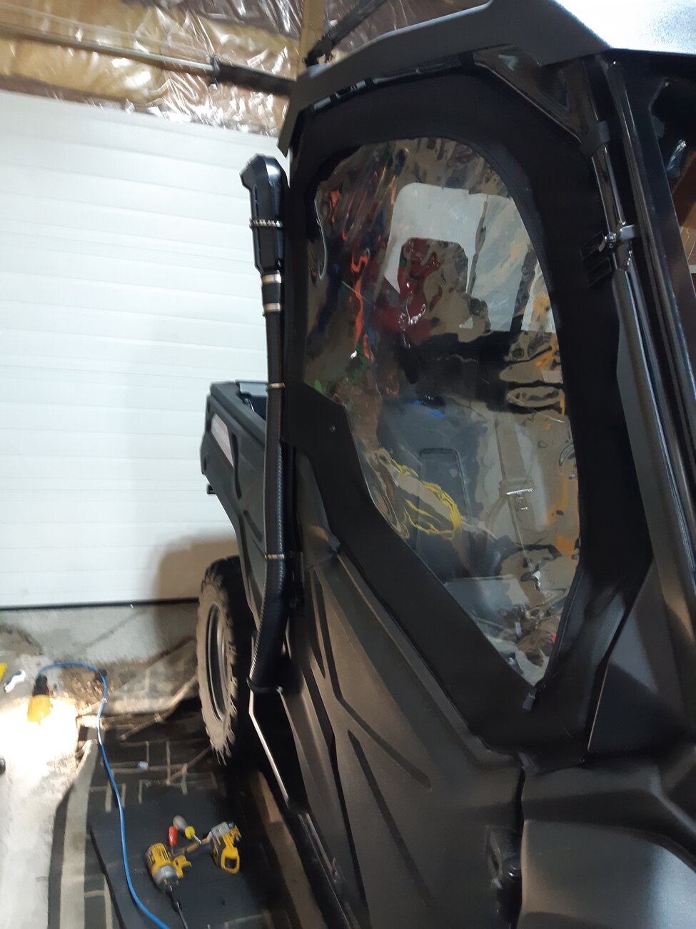

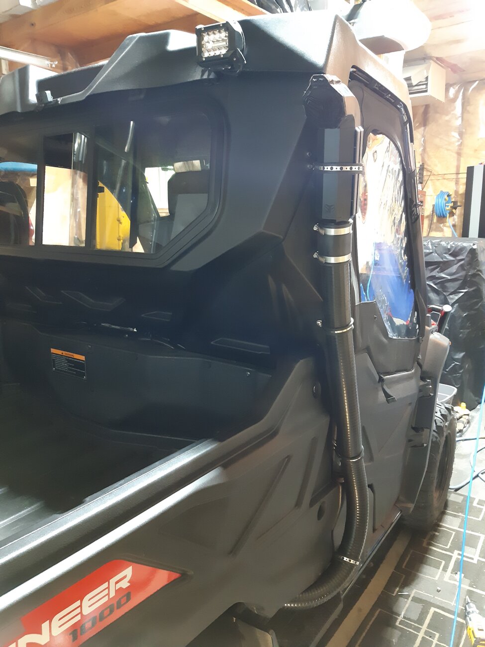

Nice! Any chance you could put up a parts list?
I ordered the riser from SYA warrior that’s 2”
mainline is 2” I.D super flex pvc line I ordered from pondsonline.ca
I had to use to 2-2” rubber plumbing connections
Right off the main air box I used 45 degree elbow that has a 2” female and a male end the female connects to factory boot from box and male end you install 2” rubber coupler to pvc line
To plug off factory piping to airbox I installed a 45 degree male/female and installed female end of coupler to factory boot and installed 2” rubber end cap on male.
