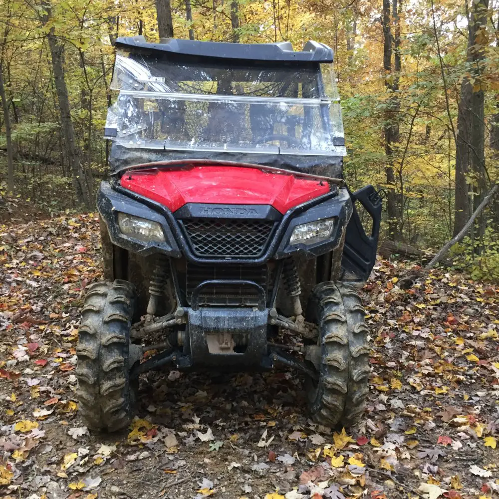

I have 27x9-12’s all around, stock rims, no spacers. No rubbing on the frame.

I'll chime in to say I put spacers on with stock wheels and tires. My first hour owning the 500 found me pinned under it for several hours after rolling over a hidden rock in some under growth in first gear. Being a MC rider my instinct was to put out foot when tipping. It went right through the space on the unhinged side of the passenger door, pinning my ankle between the door and the frame with the weight of the machine on it. Not a comfortable place. To sum up, I find it tippy with stock wheels and tires.

If gates aren't an issue and you can deal with the filth, width is safety. I'm now addicted to my 59" rear width the 50" cage. And I still find ways to two and three wheel it......

After 27s on 4+3s, I was pretty happy at 53" but didn't love the mud thrown. Installed full Mudbusters kit, which put the plastics at 56", which looked odd with the tires at 53" (well, just the rear, IMO). Have installed 1" spacers to the rear which has helped the appearance and stability. Love this little buggy, though 55-56 is a bit different in the tight woods than 50". I can still run just about any trail that a quad runs though. No regerts at all on my choices, I haven't tipped it over in a while! :)
