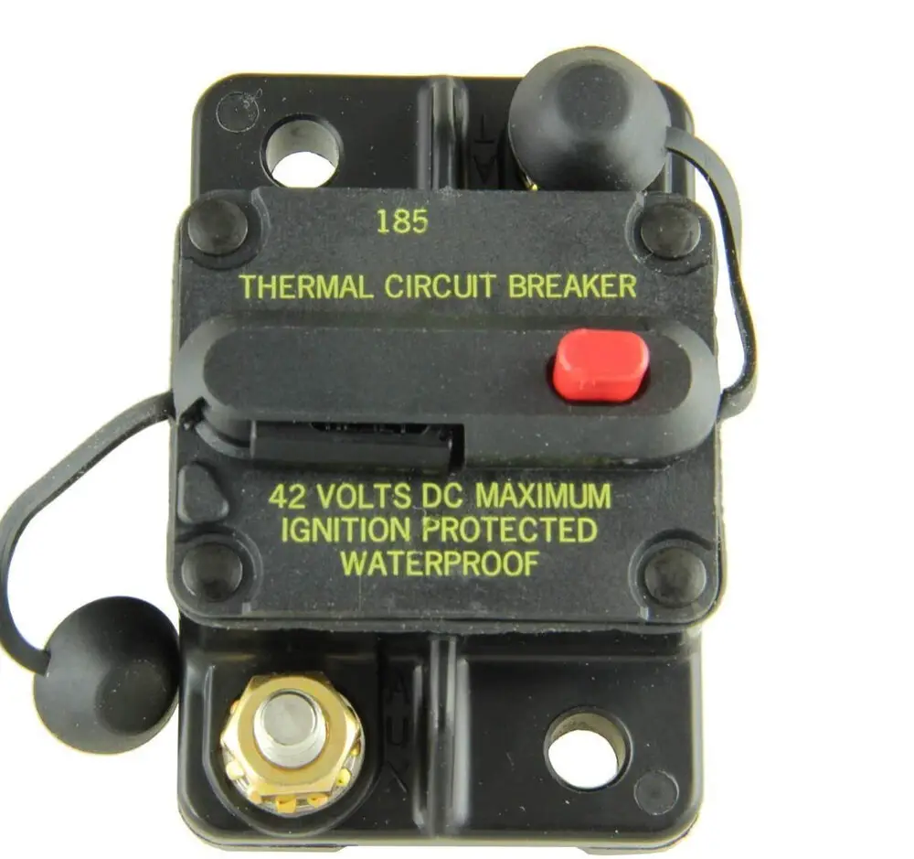

Have a 300 amp Switched waterproof breaker near the battery for high amp accessories off a 6 ga wire running to the hood area. Many amp rating options. Comes in handy to de energize the circuit by pushing the red button. ~$35

Have a 300 amp Switched waterproof breaker near the battery for high amp accessories off a 6 ga wire running to the hood area. May amp rating options. Comes in handy to de energize the circuit by pushing the red button. ~$35
Yeah that's my switch too. I have two circuit breakers wired in, one for accessories and one dedicated to the winch. I don't have a fuse block but a Blue Sea power block instead. Most, if not all, accessories come with an inline fuse and the lights came with relays.
I will definitely be adding one of those to the winch circuit.
