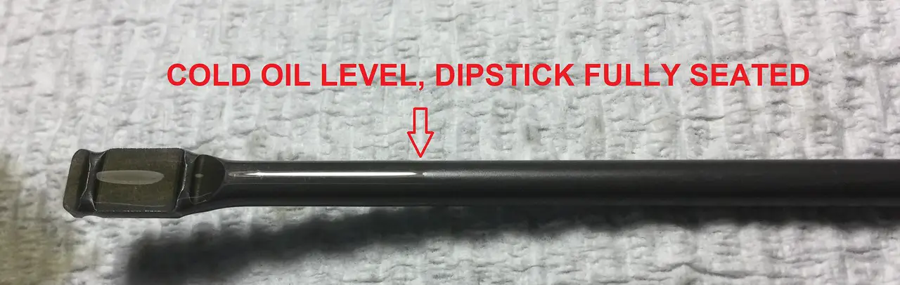

When I do an oil and filters change, I add 6 qts. 3.2 oz. per the manual and never look at the dipstick.
I also never used the ridiculous Honda procedure of warming up, shutting off, waiting for 2 or 3 minutes, then check oil level. WTF? I do an oil change, run the buggy long enough to saturate the filters, shut off, wait (sometimes overnight) and then check the oil with the dipstick fully seated - like you would before a ride or when sitting in the garage during the week. Idjits. :mad:
Right after an oil change, running long enough to saturate filters and letting sit -
I also never used the ridiculous Honda procedure of warming up, shutting off, waiting for 2 or 3 minutes (WTF?), then check oil level. I do an oil change, run the buggy long enough to saturate the filters, shut off, wait (sometimes overnight) and then check the oil with the dipstick fully seated - like you would before a ride or when sitting in the garage during the week. Idjits. :mad:
I still wouldn't be able to see it.

Mines a 21 also and probably put a quart to much, just wasn’t paying attention, it’s showing a little lower than Remingtons photo of a fully seated dip stick. I’ve always had difficulty getting it accurate, but I think it’s my fault.

On the original post, I've never tried that method(or any other) to get excess oil out, it seems that if your level is as @CID does in post #7 you'll be fine. If i didn't know how much i had put in, i probably would remove the skid plate, clean the underbelly as well as possible, drop all of the oil and start over. If it gets dirt in it, the new stuff is premeasured :confused: fwiw i buy my oil in 1 gallon jugs, 1 1/2 jugs per change no dipstick readings involved. I measure the old oil, if about 5 1/2 quarts came out i'm happy.

How about lightly file marks where you need them? Can find them with a thumb nail if needed
I did this on my Pioneer and the Talon. I only used the stupid warm up, sit 2 mins, set dipstick on top method once on each to get it right, then screwed it in and made my line with a file where the full mark was on the dipstick. Looks damn near spot on with where @CID full mark is in his photo. Zero issues in 4 years with either machine and makes checking the oil a much simpler task.

Got it done, used a transfer pump, slow process but I’m definitely going to file a mark on the dipstick, I literally hate the 2 minute warm and 2 minute wait.
