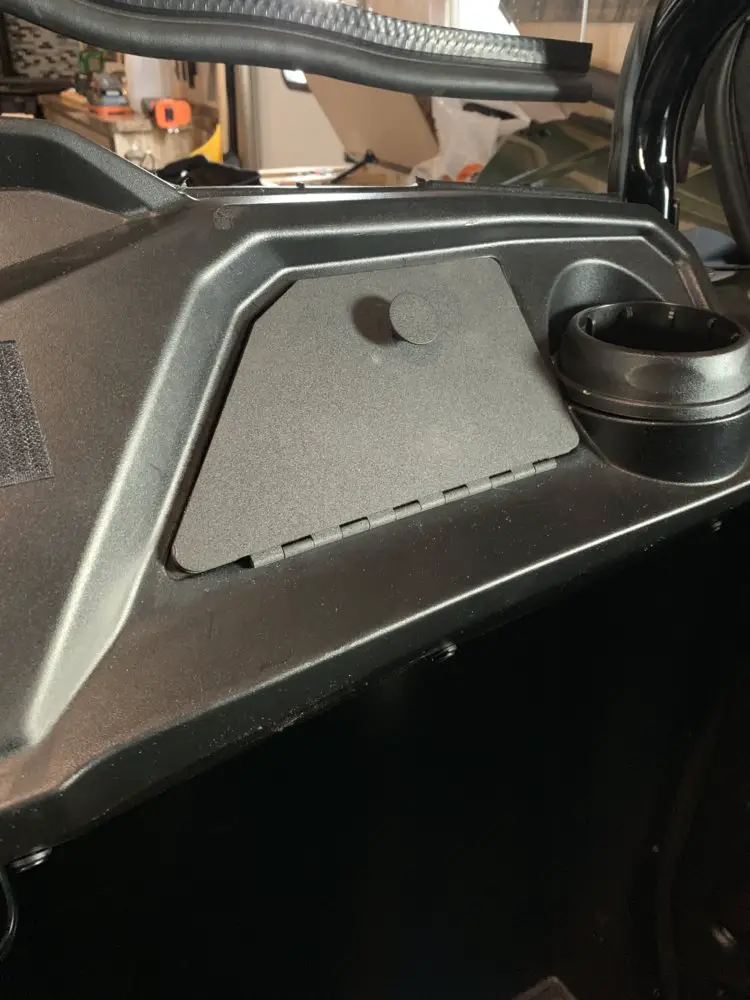

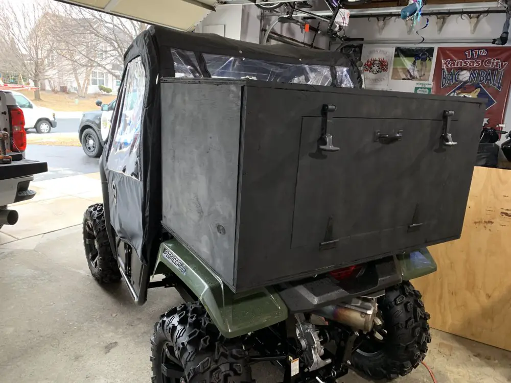

Forgot to list my box on the interior mods!!! I’m still working on installing some of my stuff but it should be ready soon

What did you keep in the big box and did it ever feel top heavy?? The seats are definitely cool.
I put all my Ice Fishing supplies inside there. Made it tall enough I could put 5 gallon with tip up inside the bucket. I never had any issues with the bike being top heavy. At least I never noticed it. Keep in mind I wasn't riding on trails with it only going across the lake.

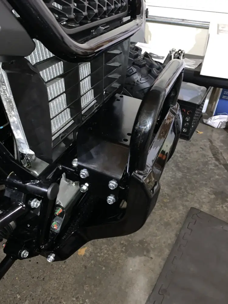

Winch is installed and it actually works. I changed out the switch and added it to the dash. I’m going to instal the cord plug under the dash on the drivers side. Need to buy a 1 1/8 hole saw first! And some pics of my Bluetooth stereo from Boss. It is made for Motorcycles but I modified it to work with a volume switch installed next to the 12v plug!

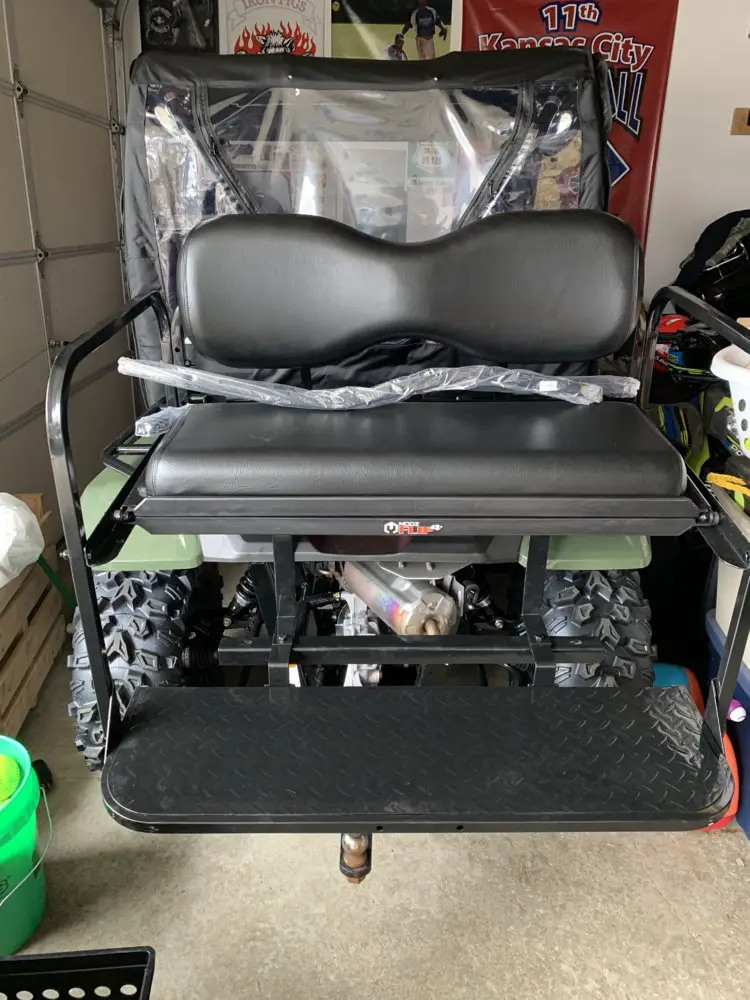

49ED6663 F175 4C8E A5EF 4D3E70BE4844
BB1F64C6 ADFB 4E9F A526 AE64FAD0E85C
5BDFA47D F5C0 46FF BE37 9B6BF22681FC
1B3553F0 97D5 4564 9A98 9C0B723CCDBE
5A1742BD 8D77 436F 88CA 62B9C48F41FE
My rear bench seat is mounted!!! I still may have a friend weld up a support for the foot rest just to make it more stable. I am not a light person bout 225# and it didn’t move much when I stepped on it.
I used 2 u bolt to fasten it on. I had to add a piece of 3/4” plywood under it to level is out where the metal was under the seat. I also modified one of the unused angle iron pieces to give the u bolts more stability.
Seatbelts for my kids so they don’t mess around while putting around the campgrounds.
I can still use the hitch too with the 1 1/4- 2” coupler. Just don’t want to put to much weight in it or things could bend. (I have a tow dolly I can use if I have to move a heavy trailer!). 557317C2 DD57 4D0E 9403 6C174332591C

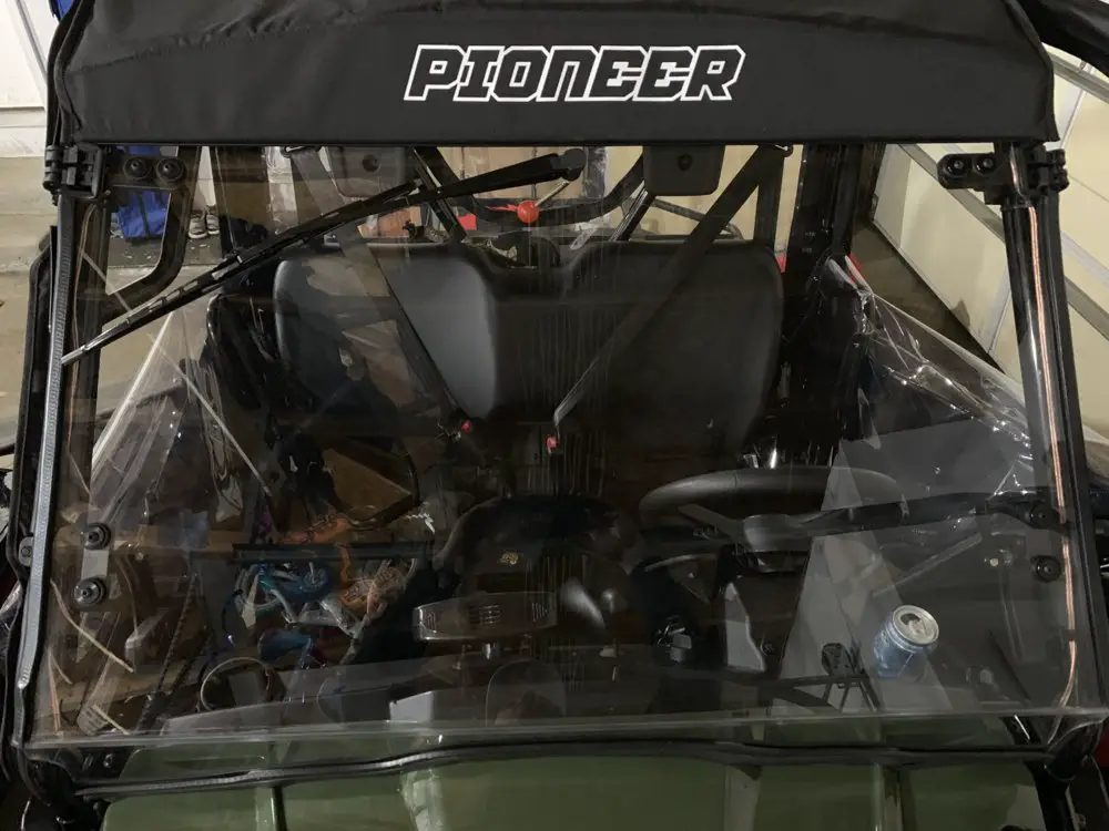

BB8A3D32 3F99 40FF 8629 5532E985B833
668D0373 3C55 44DA 80F8 F8D67CB1ACF5
25259900 DA93 4B6D A9C6 370E5975DABB
63C27845 737D 4E50 BDDD F38D26F044F6
34714D02 BBAD 40B7 9ED3 67ABD213FE3A
Heater is installed! I have to refill the coolant and hook up a couple wires tomorrow then test the heater. It definitely takes up some room under the hood but that is to be expected. The vents look nice and give it a nice factory look.
Just have to cross my fingers I installed everything correctly and it works when I test it in the next couple days.

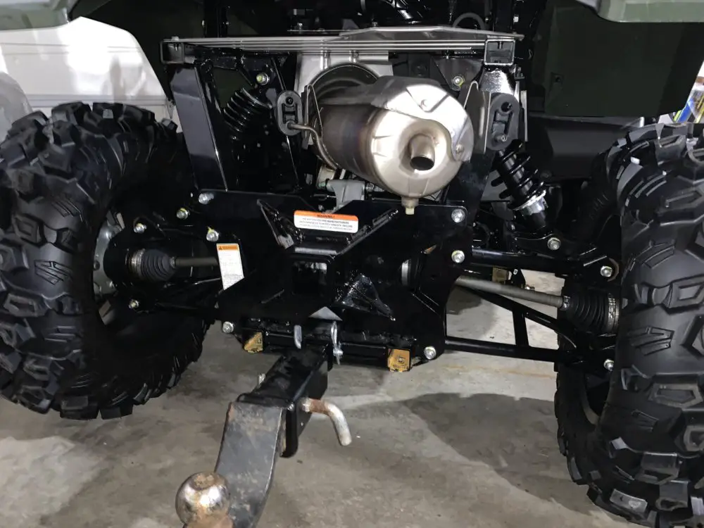

Very simple to remove. 6 bolts hold it on. Simple to take off only take about 5 mins.
