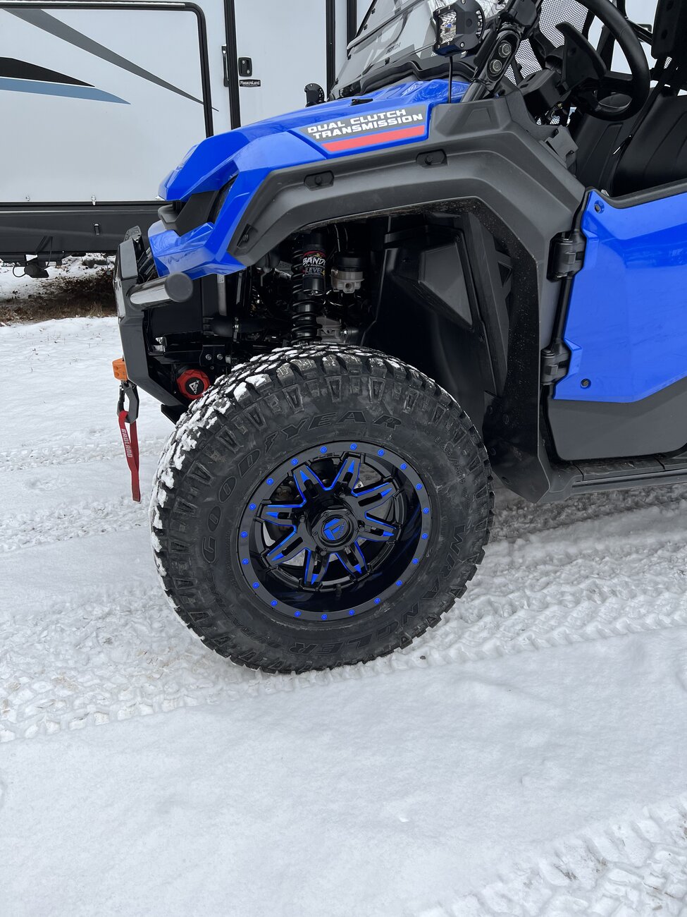

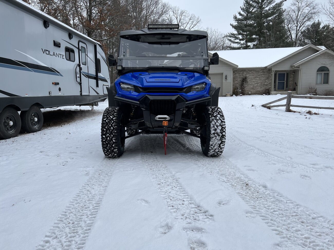

ok here are the pics ….. 15” fuel rims with a 4+3 offset and 1” spacers on rear. Running 235/75R15 Goodyear Wrangler Duratracs. 10 psi front and 12 in the rear. Front tire height measures at 28” mounted. Overall stave was widened about 2.75 inches. I have a slight tire rub on the front but I am running my bandits plush with the minimum amount of preload. Performance seems better with more grip. Braking is noticeable but not bad. Overall weight gain is about 28lbs. Factory fronts weighed about 42.5 and rears at 48.5. The aftermarket’s weigh just under 52lbs. I don’t think that is bad considering.

I’m guessing that the only rubbing is from the lower part of your mud flaps.

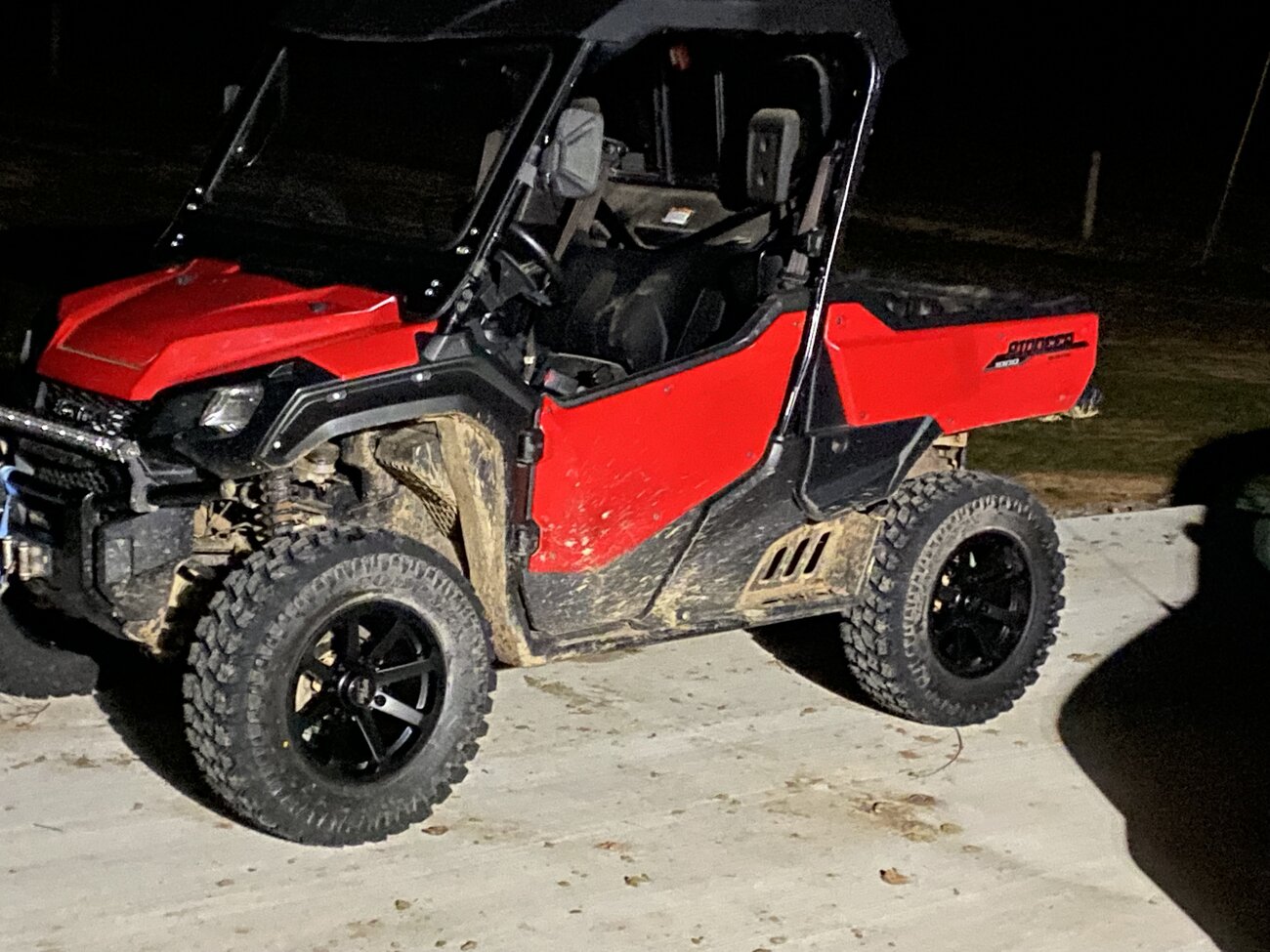

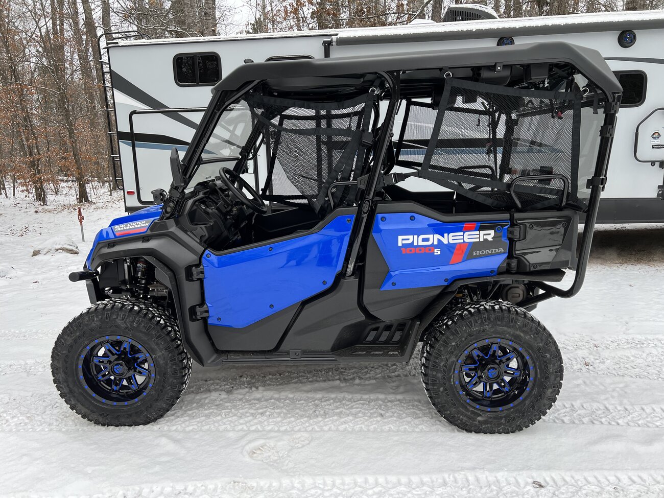

I am running a 15” 4/3 offset with 235/75/15 LT. No offsets, and no rubbing in a flex. Love the set up, goes great off road and handles like a car on road.
Nice! Looks good! What year and miles? Thanks for sharing a pic of your rig on your first post! POIDH☑️
