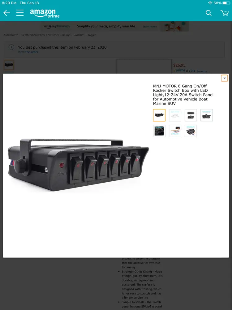

I ordered this from Amazon and have had no issues with it. I’ve sprayed it with a pressure washer with zero issues afterward. I believe it was around $30. I mounted it to the front overhead roll bar in the center.

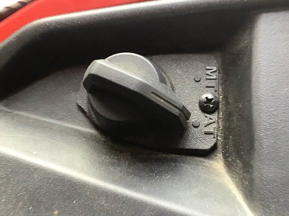

This is how I moved it (2 pics). The harness barely long enough but made it. Hope that helps.

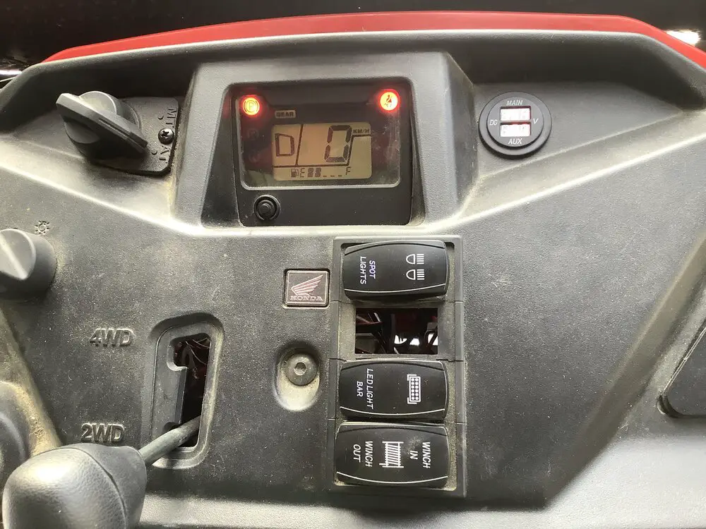

I decided to move mine to where the cigarette power port was. The hole is the exact same size. Only had to mark and drill 3 holes for the retainer/label plate. Harness reaches perfect as well.
Eventual plans are to use the existing cigarette power lead to power my USB/cigarette ports I will be installing in my Goochbox.
I wanted the dash real estate where the MT/AT switch was for my bluetooth stereo control panel and winch rocker. I like to be able to use both modes for various reasons, and having the switch out of the way but still accessible is perfect for this.
