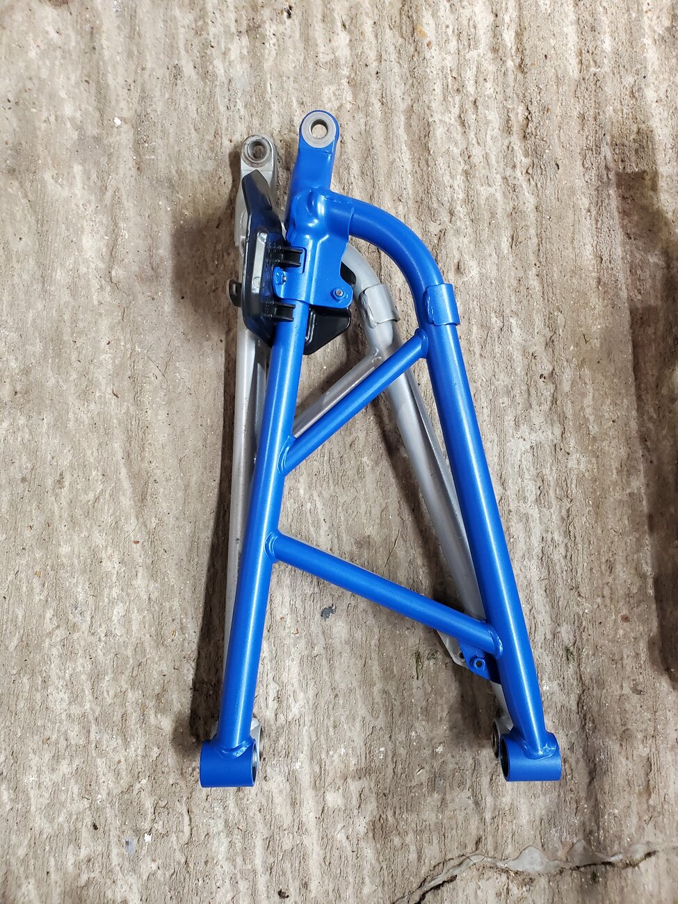

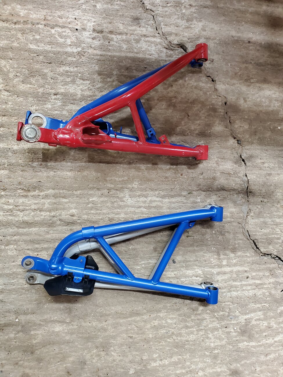

My new set of R4 arms were delivered yesterday!
20240329 171357
20240329 171414
I don't think these could be any newer. The member here that sent me these said they were on the machine for no more than a mile before they were swapped out for SATV Talon R arms for tire clearance and it shows. They are mint! I'm going to need to order ball joints and bushings, and get the car finished up before I get these on so it may be a few weeks.
@Tramguage1, how long do you think you would need these if I sent them to you to jig up?

I just had cataract and lenses replacement surgery on my right eye on 3/29. I am scheduled to do the left eye on 4/5, so it could be a month or two before I'm up to 100%. Please don't wait on me.
Are the lower arms flat from bushing to ballpoint hole?
