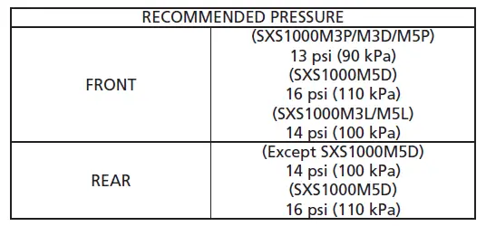

Generally speaking, you should refer to the owner's manual for the vehicle itself (SXS, car, truck, whatever).
My owner's manual (2021), page 206:

Adding to what Lee said -
1. The pressure molded on the sidewall is max inflation for that tire and has nothing to do with the vehicle the tire is on. The same tire may be OEM on many vehicles of wildly varying weights. I'm running a BFG K02 LT tire on my Talon, the sidewall says 50 lb. max but that's for a ~6000 lb. truck, I'm running 9 F, 10 R and could go lower. (Talon spec is ~16 lb.)
2. The spec plate on the vehicle takes in to account the vehicle's weight and its intended use. Lee's example of crazy high pressures for the rear tires on a PU are for the expected/possible loads. My PU is my daily driver and almost always empty, I run much lower pressures than the spec plate because there's no weight on the rear axle with the bed empty.
3. To the OP's question - for a day ride on pavement, I'd run Honda's spec for the Pioneer as posted in post #3.
That's the point I was trying to make. Thanks for providing more detail.
