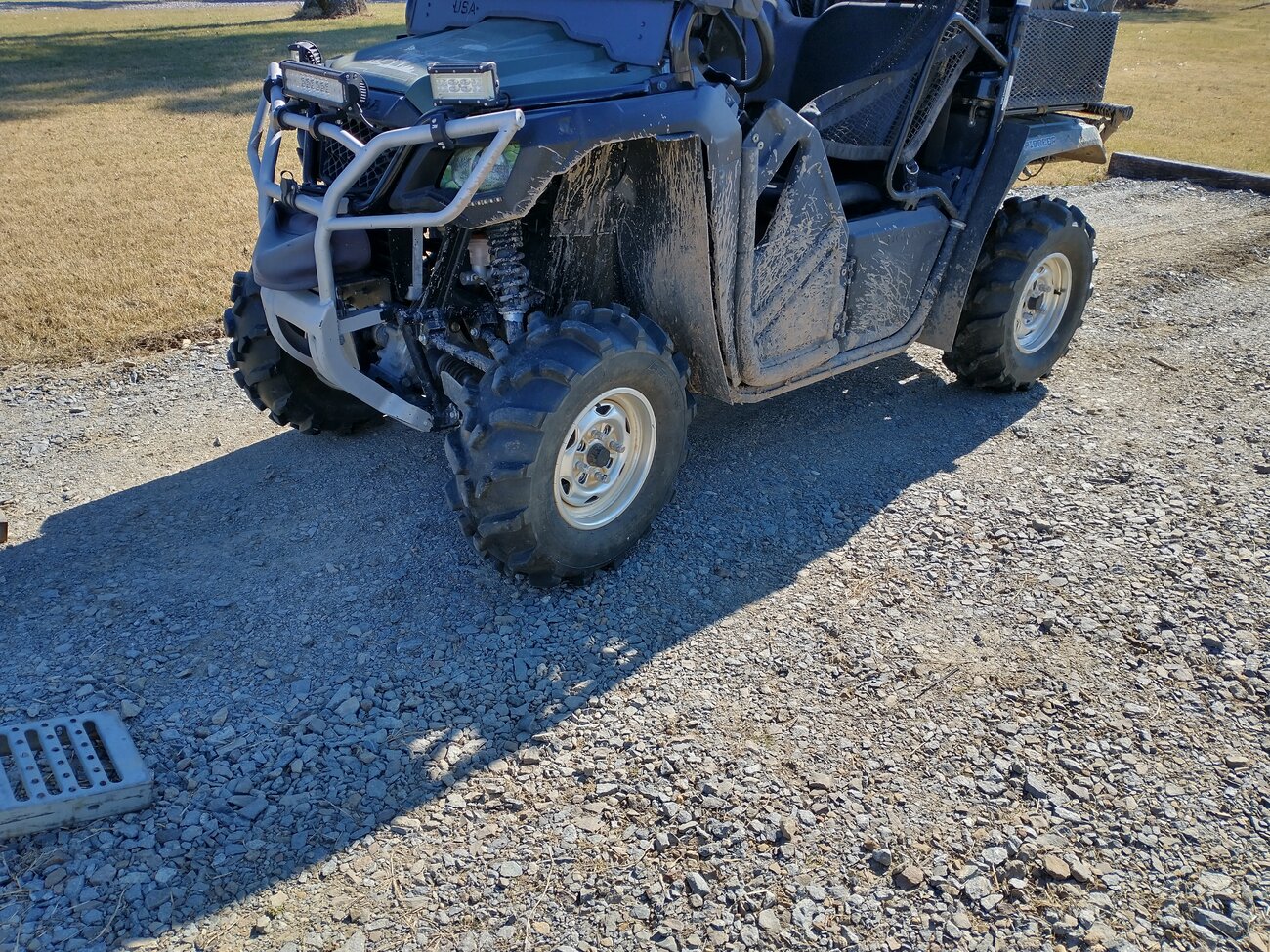

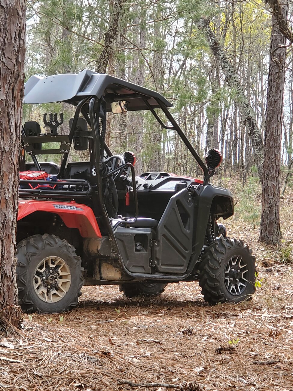

I also wanted to use aluminum Rubicon wheels (2006) on my P500. I had an extra set of wheels, and bought two more six inch wheels so I would have four 6" wheels. I drilled the holes with a 9/16" drill bit to match lug holes in OEM P500 wheels. Then used a round stone rotary grinding bit to match the ball radius lug seat.
View attachment 326701 View attachment 326702
6335C550 83E9 4CB0 8869 6D8DBBE91842
Rincon rims with 26” Goodyear Rawhide rubber.
