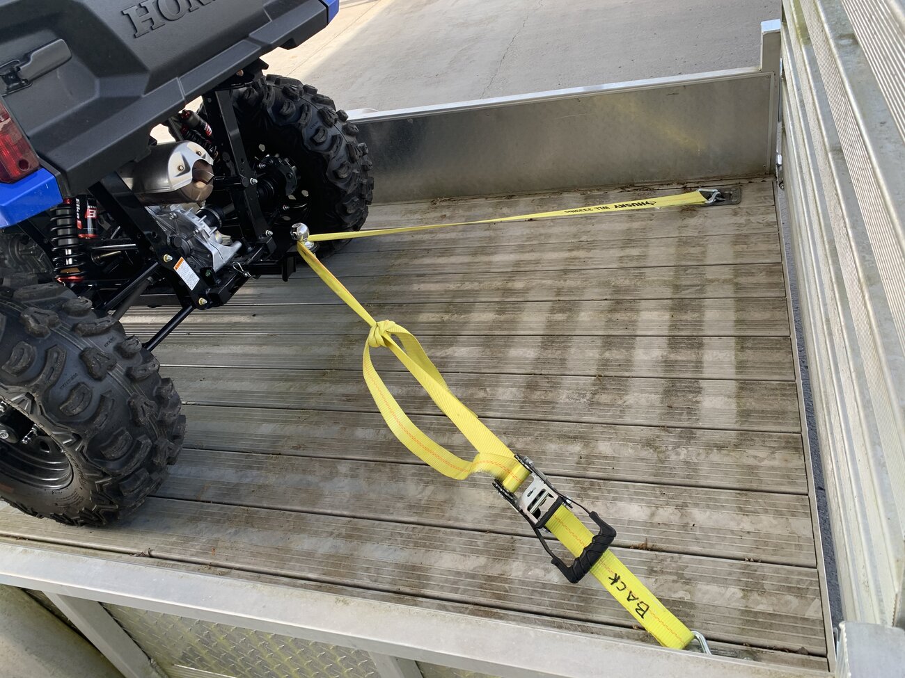

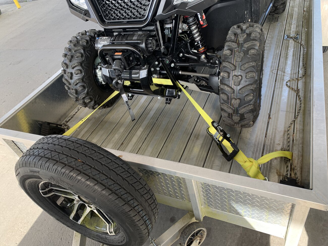

This is how I strap down the P520. It's never budged. That said, I did buy etracks that I have yet to install on the trailer. I will eventually use both methods.
That how I do mine except I put a bar through the frame holes across under the muffler and route the strap over it instead of the hitch. I have 20,000 miles of towing without any problems.
