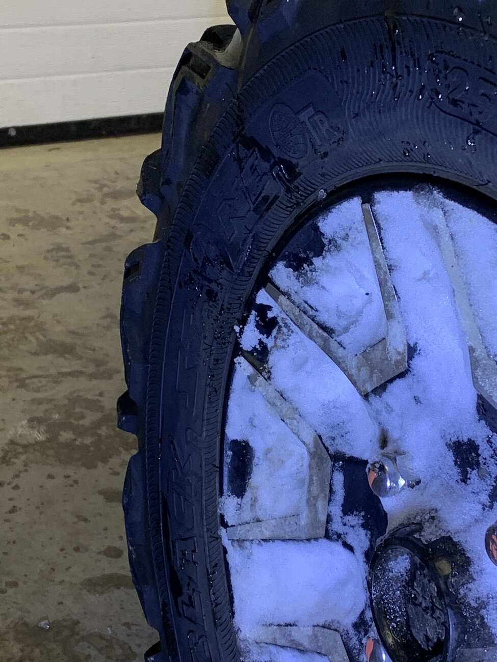

Hello all,
2020- 700-4 deluxe owner 800kms stock tires
been wanting bigger tires as the trail I ride is full of rocks. And scrape time to time.
I tore my side wall today, and now need a new tire, so mise well upgrade to the largest sizes I can
can you please tell me the biggest tires I can put on my stock aluminum rims. Please suggest brands too
I live on the east coast of Canada, rocky dusty trail is what I drive, plus use it in the winter in the snow

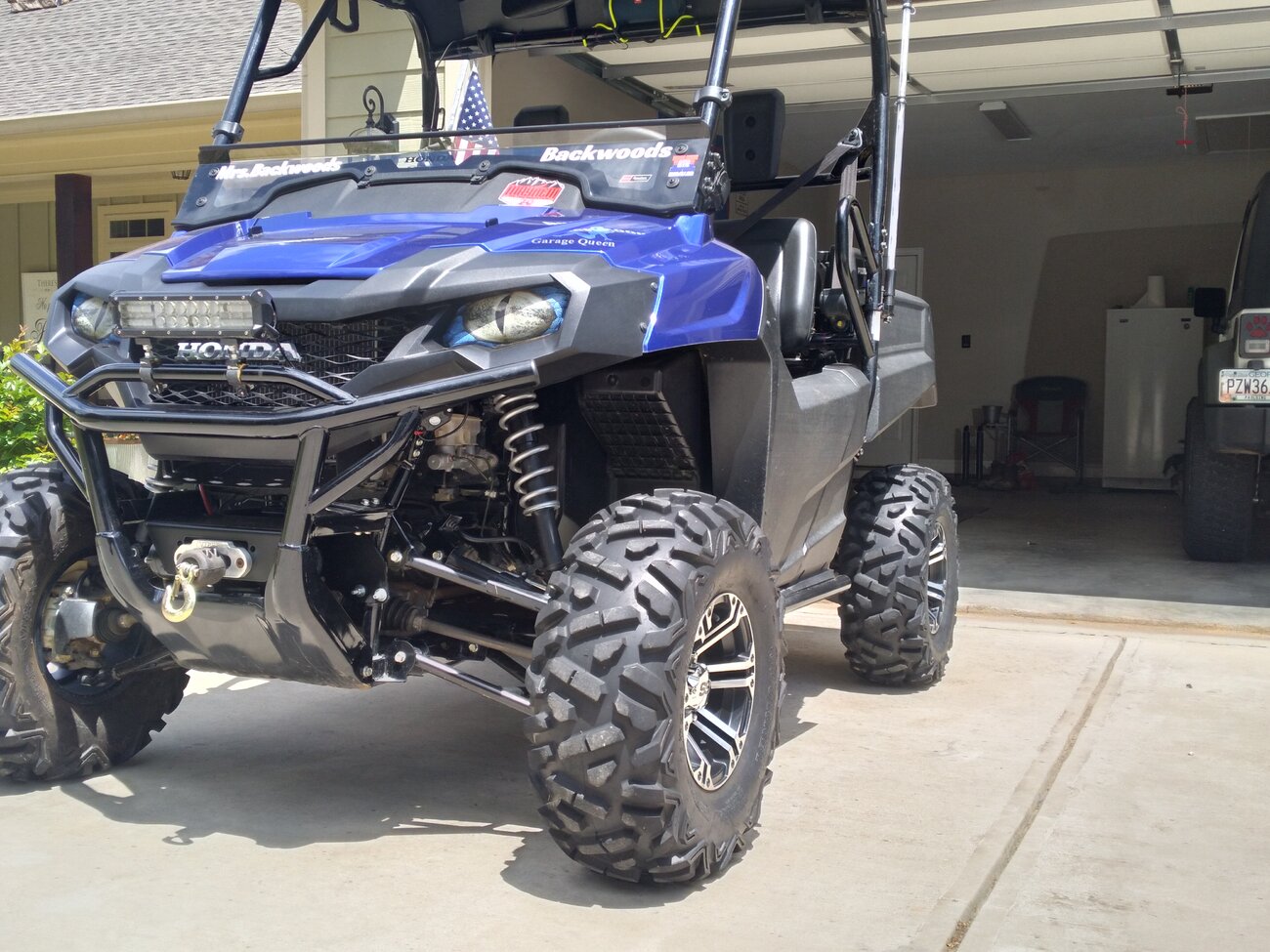

27" is the tallest you can go without a lift. ITP Terra Hooks would be a good tire for the terrain you are describing. A lot of guys on here are running them. I like the blackwaters but they have deeper tread and do better in mud. Get you a good UHMW skid plate too if you haven't already. That will protect your machine from them rocks

ITP makes a Terra Claw that looks even better but they are made for a 14 inch rim. I recommend Bighorn type tread pattern, Blackwater, Dirt Commanders.
