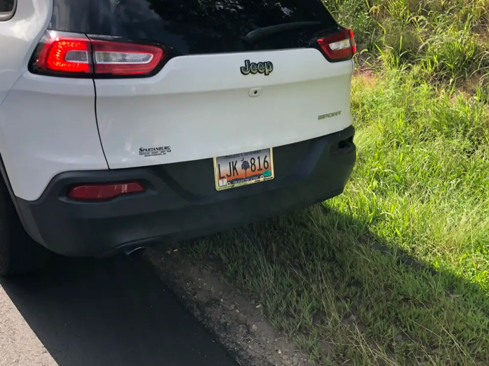

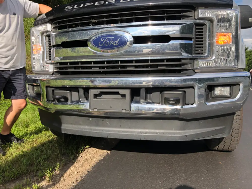

Wasn’t bad. Traffic was stop and go and went from 3 to 2 lanes. We were at the end of the merge zone and traffic had started moving. A BMW tried to come around the left side of me. I glanced in the rear view to check on it and when I looked forward traffic was stopped. I was going less than 10 Mph and needed another 10 inches or so (or the trailer brakes not locking up) to stop
The damage
I pushed the heep about 6 inches down the road. I believe my right tow hook is what destroyed the reflector on the heep. I had er locked down hard

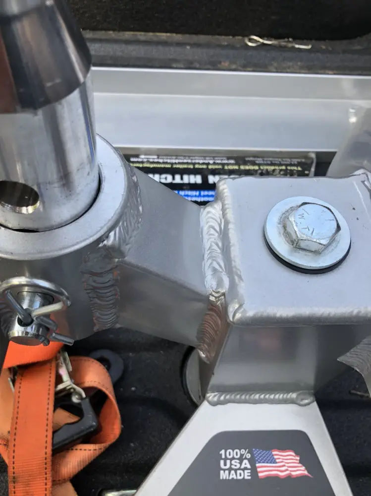

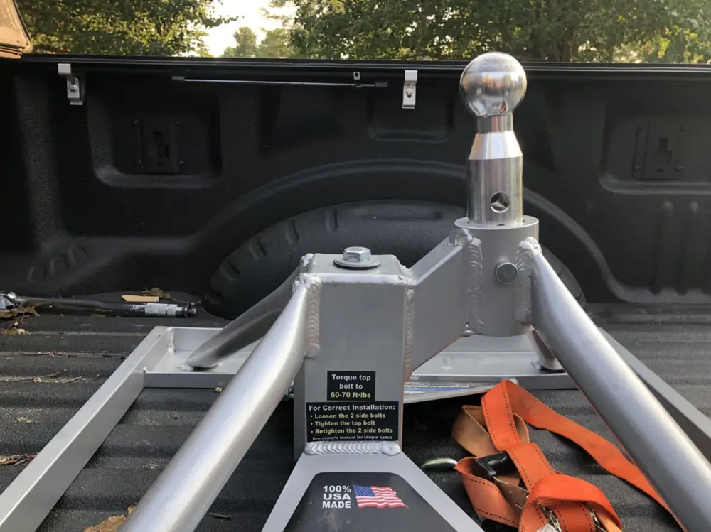

Got home last night and finished unloading today. My Andersen Ultimate hitch may be a casualty as it is racked a bit (see pics below) and the bed floor where the front of the Andersen rests is dented / crushed
Bbaee2abd4502512a5c120390dbc1d17
66f3467d30b016549f0fd4b7a11e26c2
^ hard to tell but there is some dimpling in the diagonal square tube
1ea38ab0331c0d0ba013c14b912b88c9
92b3163b84946a809dfeae9b489d3a81
Amazing thing is with a retorquing this thing continued to work fine. Guess I’ll be calling Andersen and getting their opinion tomorrow. Somehow I see a B&W Companion or Reese Goose Box in my near future ....

I would think that the metal is compromised. I would not use that again. Stressed and could fail easier. Just my guess. I do have the Andersen and love it.
You are correct. Andersen is replacing at no cost to me. Bigger issue is the ribs of the bed are partially crushed under the front edge of the Andersen. I may have to go a different route ...

Or replace the bed but that probably means an insurance claim and you may be wanting to avoid that. How much is it off. Could it safely be shimmed?
The advantages to the Andersen are 1. It is about 150 lbs lighter than a standard hitch. 2. It has less slop. 3. Is is not as noisy. 4. I does not have the chunking that a standard hitch has. It is smooth and quiet.

I have ordered a Goose Box. Will try to sell the Andersen. I believe that the crushing of the aluminum bed floor might be a recurring issue

The Andersen attaches to my B&W turnover ball. I am changing to a goose box that will connect directly to the ball.
The Andersen raises the attachment point and utilizes an adapter on the OE pin box
