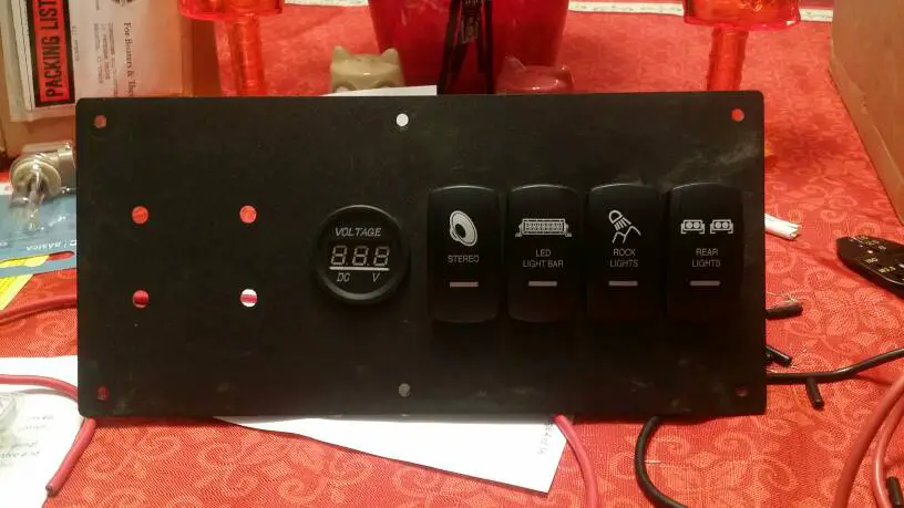

I'm finally getting around to getting my wiring project started. I ordered:
1. Marine grade wiring
2. OTRTTW switches
3. Rock Lights
4. LED Light Bar
5. Fuse Block
6. Circuit Breaker
The only thing left I have to buy is the connectors. Where did you guys order connectors from? I know I want to get something weatherproof. I only want to do this once so I want to get quality stuff!

Smart man right there. Is there a Blue Sea Systems fuse distribution in that list that I'm missing? I purchased my connectors for this project from Amazon. Crimped and soldered, then shrink wrapped.

Thanks Montecresto! Yes sir I bought a Blue Sea Fuse block. I found a online boat wiring store online. I went ahead and ordered all of the connections I need from them. Looking forward to getting them in so I can get all this stuff wired up!

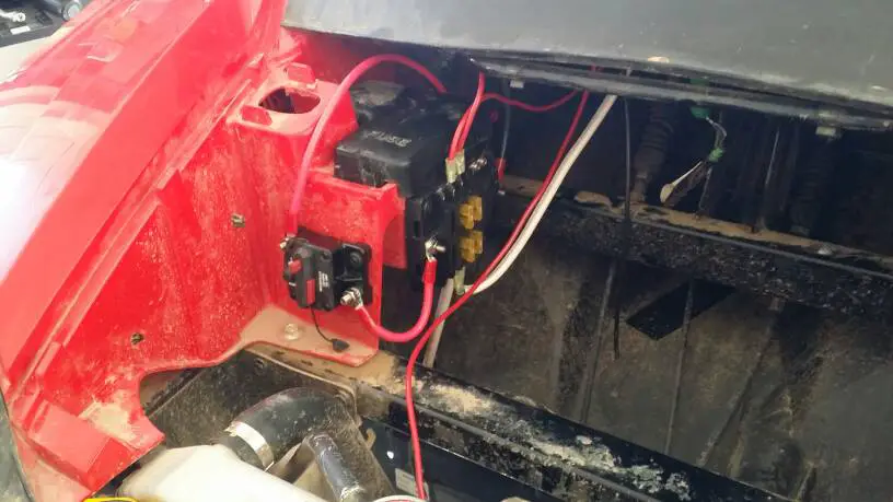

Good deal. Good luck with that project. Split wire loom (conduit) is good to use also. Looks like this.

All of that attention to detail not only looks nice, but at the end of the day it will perform as well! I try to take my time and do a neat job... I find myself upgrading what comes from the OEM, understanding that they are in "production mode" and it may not be efficient to go the extra mile. I get it, I really do. But a little extra tape, some dielectric grease, wire loom, wire ties, etc. all do add up. I want my stuff to work as well 75 miles into the woods as it does in my garage!

I think that's the best approach right there!!!

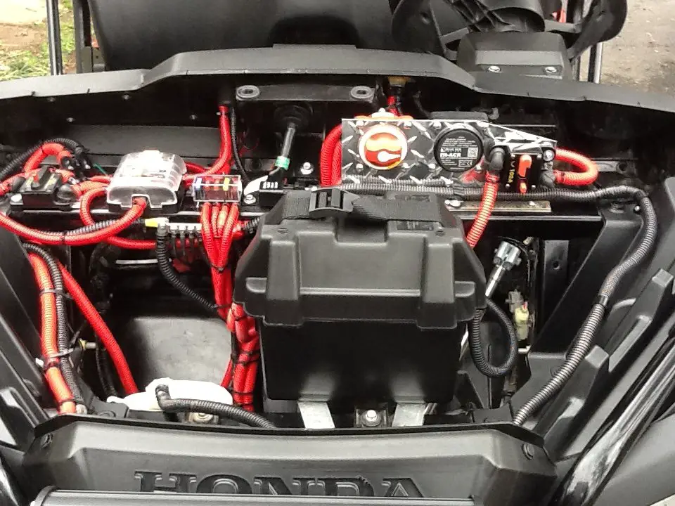

Yeah Monte that looks really good! Wish mine looked like that, there is a reason you all haven't seen a picture of under my hood!
Yeah, but you're the premier welder. ;)

Wiring coming along! I hope to get more finished before a ride at Windrock coming up this week!
Sent from my SM-N900V using Tapatalk
Take your time that's all the difference between looking like Montes and a crow nest. You've got lots of good items can't wait to it's all in your experience will be better!
