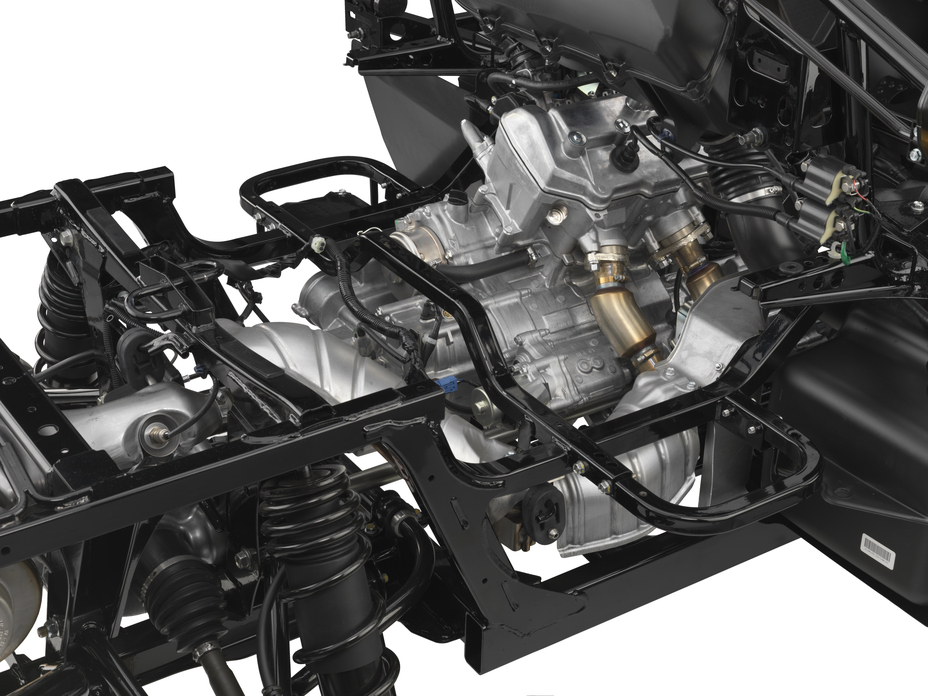

Considering the time and money that needs to be invested to achieve this... you are better off buying the Can-Ham. Its built for what you are looking for.
With the Honda, the engine head will be in the way. It's tucked between the bed and the rear seat.

I personally wouldn’t invest the time and effort into turning a P1K6 into what the Defender Pro already is.

Thanks. Couple of ways to address that issue.
admittedly, I haven’t researched this model much but after a few minutes on YouTube and the net, I like even more the features that Honda put on this unit that I didn’t previously know about. Tow/haul, stiffer chassis, self leveling rear suspension, return to center steering, upgraded eps assist. These in addition to the Honda reliability (gear trans) and toughness make this little idea exercise even more enticing.
I’m always looking for an excuse to fabricate something and sure it’ll take time but I still have more research to do.
Would love go get my hands on the technical drawings/illustrations for this unit, owners manual (should be easy to find), and a Honda manufacturing 3D model would absolutely be icing on the cake.
@Hondasxs ,behind the front seat structurally, it’s actually a P1K-3 isn’t it?
