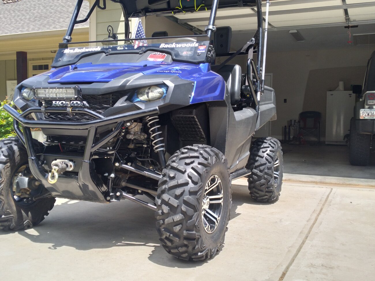

When I had my 700 I ran 5+2 0ffset and 27x10x12 on all fours to be able to rotate. You have plenty of room they will not rub

Now with all this talk of what you were looking for then got and no pics! 🤨

Too clean. Gotta get that thing dirty so you can wash it. My name is MUD.

I just cleaned it up when I replaced the tires. I am not much of a mudder but do like to trial ride. I have some friends that have access to a lot of property and Barnwell Mountain recreation area isn’t far from us. We have been to a couple of others but do want to go back to hot springs Arkansas.
